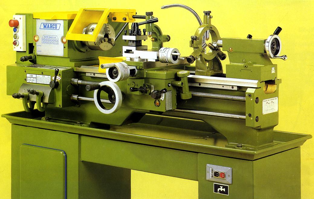

UK-market by Warco - as supplied during the mid-1980s as the "1327". Other suppliers offered similar models.

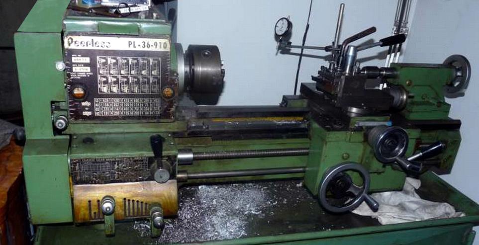

Badged as a "Peerless" - and as sold in Italy
