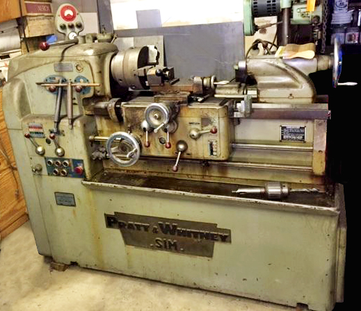

Not an "engine" lathe for general workshop use, the SIM T5 was intended for production use. Hence, it could not produce threads but was equipped instead with power longitudinal and cross feeds - each fitted with four micrometer-adjustable stops. Thus, a repeat production job could be set up with the necessary cuts already arranged and an unskilled operator employed to do the work of loading and unloading a job. In addition to a 4-way toolpost, a second multi-holder rear toolpost was also fitted.
The lathe, intended for continuous heavy work, was very strongly built with the bed and base formed as a one-piece casting in iron, with multiple internal ribs to add stiffness. Bedways - and the cross-feed screw were hardened and ground.
Although strongly built, the lathe was of limited capacity; the swing was 13.75 inches and the capacity between centres just 20.5 inches. With a 1-inch bore, the headstock spindle was in a case-hardened chrome-nickel steel, ran in three high-precision roller bearings, and, driven by a powerful 7.5 h.p. motor, had eight speeds of 180, 250, 355, 500, 710, 1000, 1400, 2000 and 2800 r.p.m.
Nine longitudinal power feeds of 0.0015, 0.002, 0.003, 0.004, 0.006, 0.008, 0.0012, 0.0016 and 0.024 inches per rev were available with the power cross feed rates set (as usual on this class of lathe) at half the longitudinal.
The lathe was 65 inches long, 32.5 inches wide, 53.5 inches height and weighed 2880 lbs (1.28 tons).

This is a SIM T4 with a 400 mm swing. The owner reports that, despite being a production lathe intended to be worked to death, this one is very good condition with no wear evident on the bed ways and all the feeds screws tight. It is to be cosmetically restored and put back in full working order.
