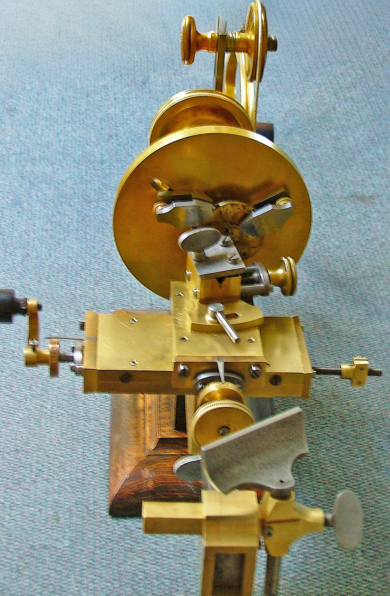

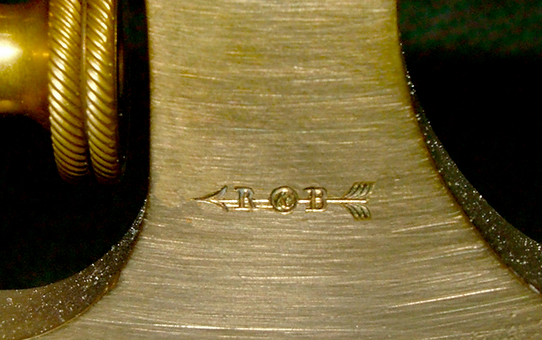

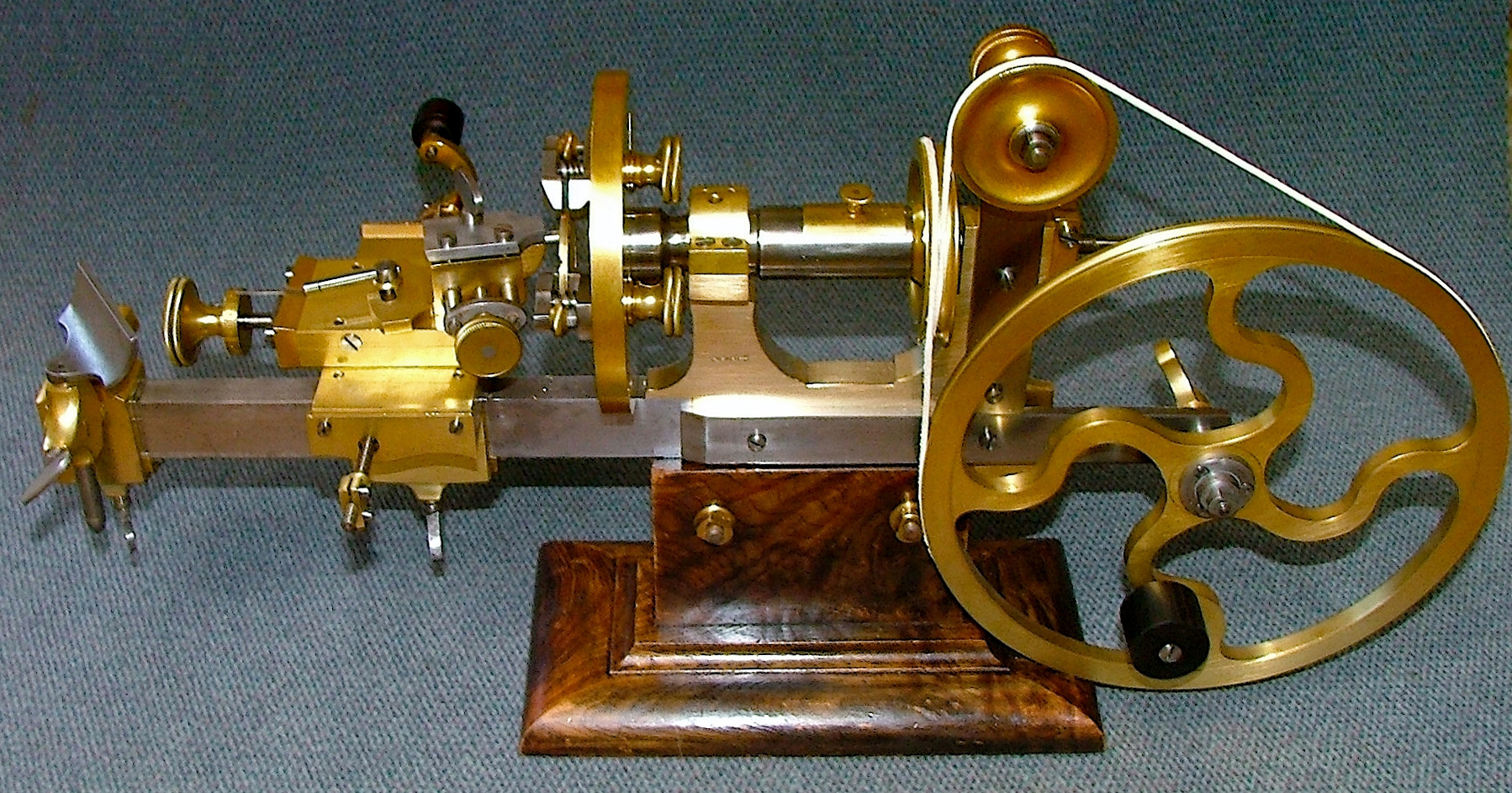

Very few of these lathes carry a maker's name or mark, and when the writer visited a collector of these lathes in Zermatt, Switzerland, none of his collection of fifteen examples was marked by its maker. Hence, it was rather exciting to discover that the example shown below, and resident in the Netherlands, was identical to another example found in Switzerland and marked "ROB"; the O in the middle being inscribed inside with "&c", and the whole stuck through with an arrow pointing to the left.

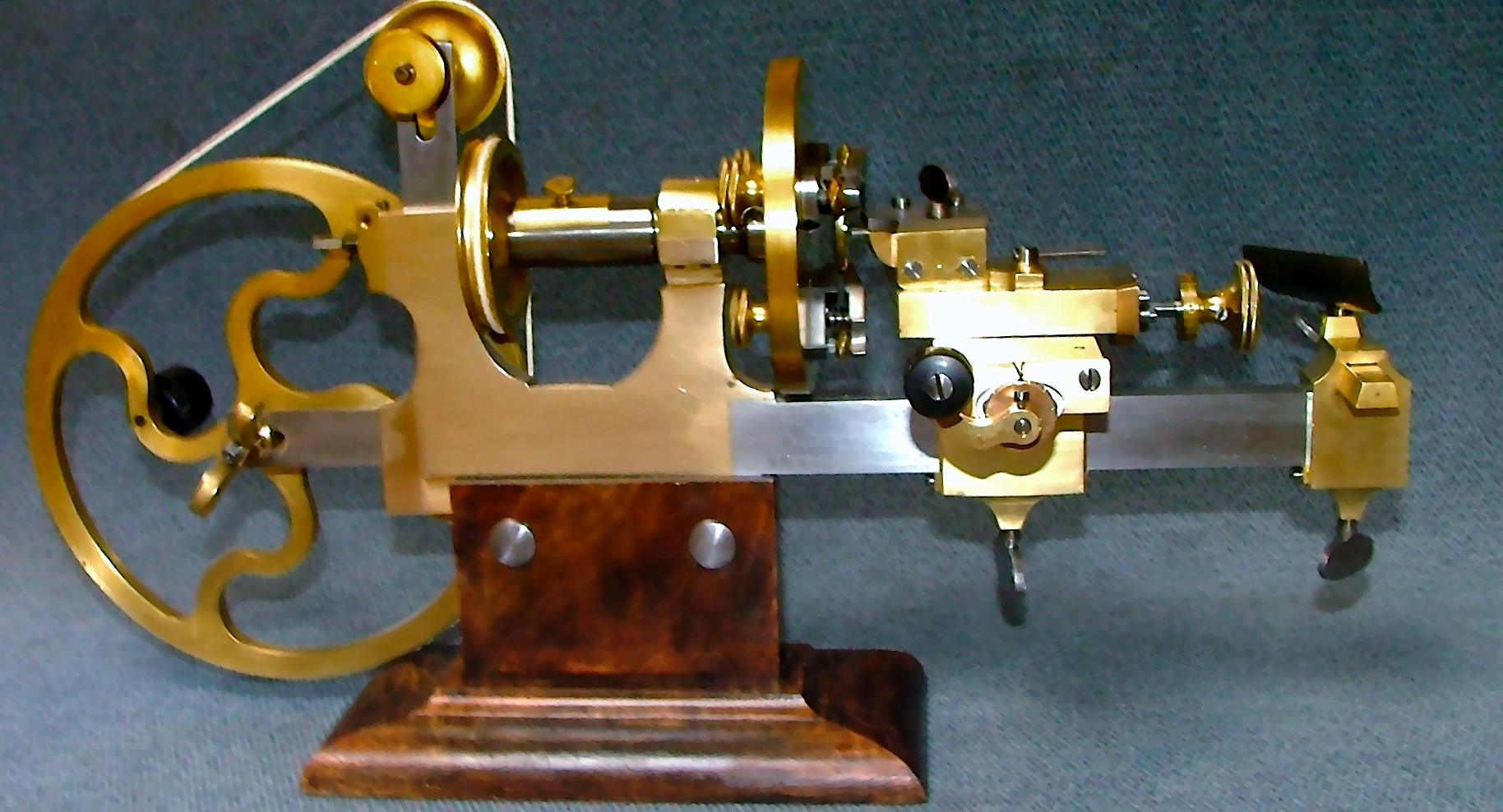

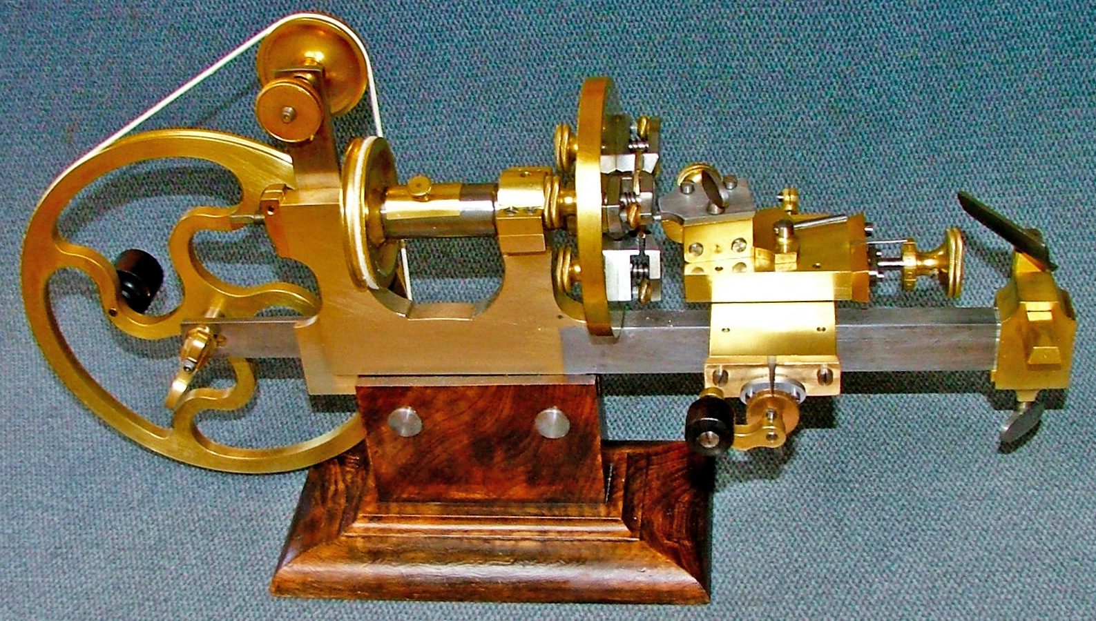

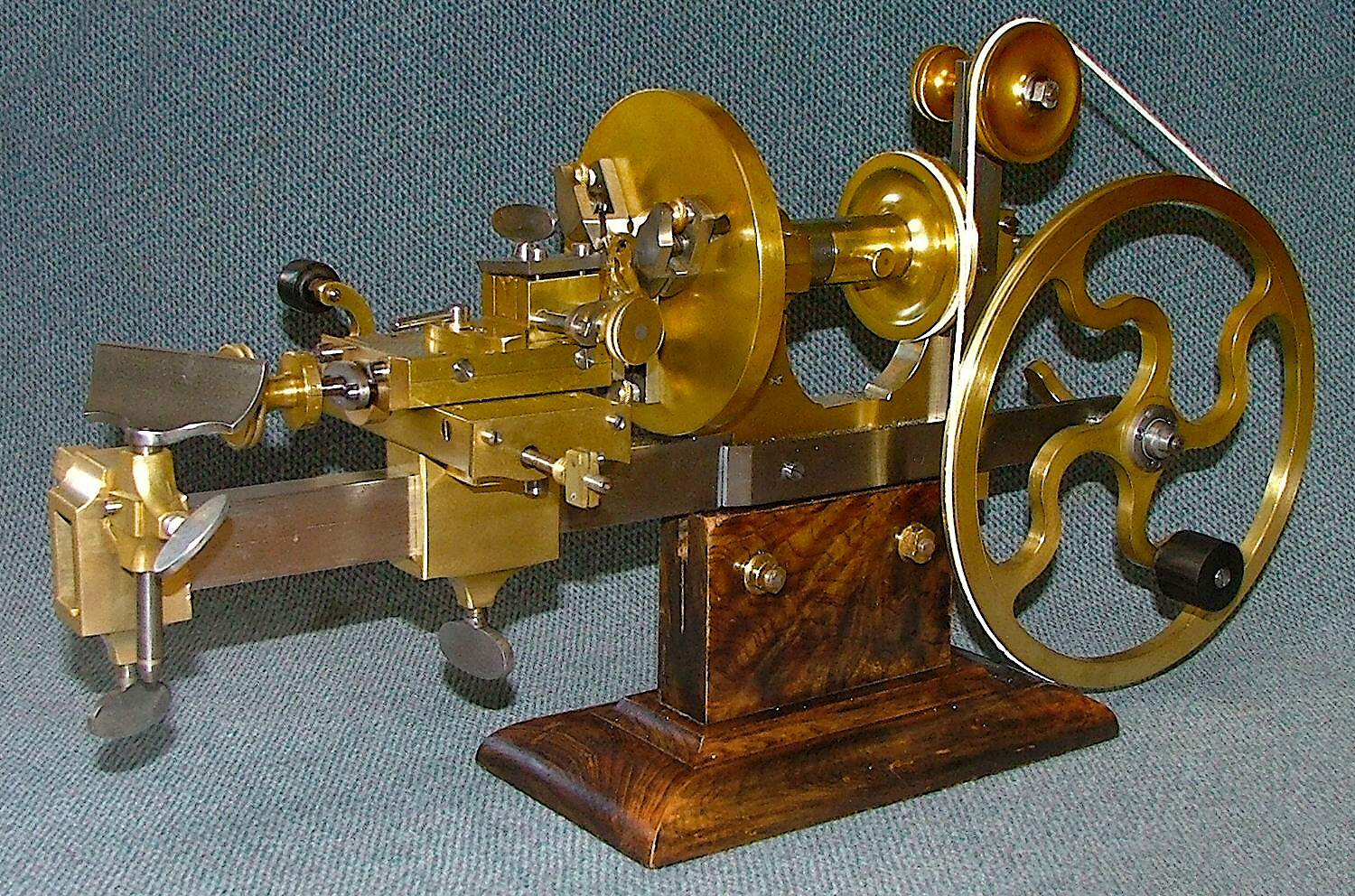

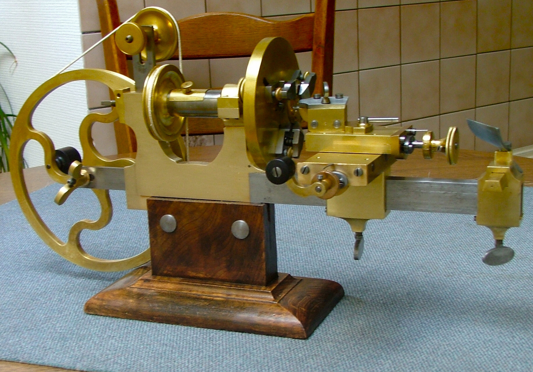

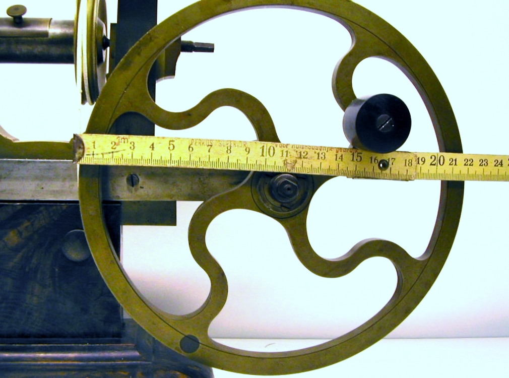

The first of this type of lathe was introduced during the 1700s, possibly by the inventive watchmaker Vauscher, based in what was then the centre of the trade in the Swiss town of Fleurier. The example shown below is typical of its type, with its headstock and bed cut from one piece of a bronze alloy - both of rather short and slender proportions. Also a common feature of the English Mandrel, the spindle was supported in a single bearing at the front and against a hardened centre at the rear; this was a simple but effective arrangement, reflecting contemporary small-lathe practice for much of the 1800s, as typified, for example, by some versions of the Pfeil. To make the machine as compact as possible and free it from the complications of a separate, complex rope-driven countershaft, the lathe was often equipped with an integral drive system - probably the world's first - in which the spindle was turned by a hand-operated crank working through a step-up ratio, spiral-form gear. However, in every case, the drive gear was bolted on and could be removed if required, with provision for an alternative belt system often included (or able to be subsequently added by owners). However, some examples of a rather more complex design, with part-bronze, part-steel construction, have also been found, as shown below, with a neat, hand-powered round-rope drive. These varied in construction, with some being arranged to turn through 90 degrees to wrap around a pulley on the spindle centre line - the pulley then acting as a catchplate to turn the spindle through a drive dog. Yet other versions, with drive direct from a gear cut into the periphery of the hand-turned wheel meshing directly with a gear on the spindle and ones where the rim of the faceplate turned to accept a rope drive, also exist - though the latter would have required the use of a separate countershaft and its associated complications of drive and mounting.

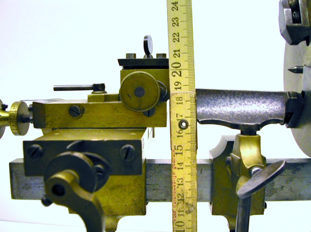

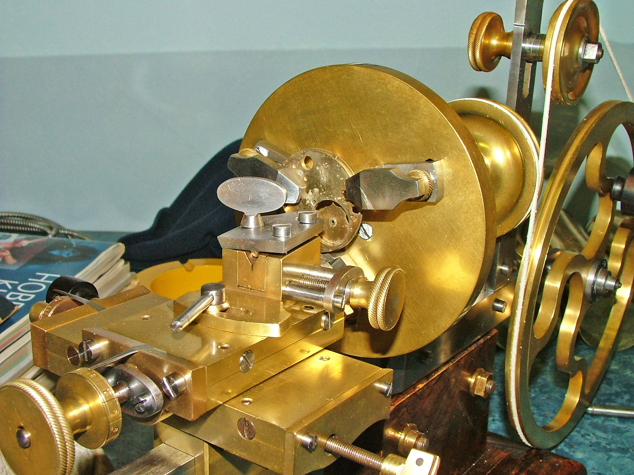

Another of the lathe's significant features was the inclusion of a decent compound slide rest, which allowed the operator to precisely control the cutting tool. In many cases, these lathes had what appeared to be three slide rests, as in the later American Derbyshire lathes. However, on the Swiss lathes, this fitting was not a slide but a very clever means of adjusting the tool height. The action depended upon two pairs of opposing wedges that, when moved towards each other, lifted the tool and, when moved away, lowered it (it being necessary to slacken the top clamping screw first). The wedges were shifted by two round bars, pushed by a plate under a screw action, with their inside (hidden) section formed with wedge faces - each facing in opposite directions, of course. As was universal at the time, a hand T-rest was also provided, mounted on its own separate and adjustable bed rest.

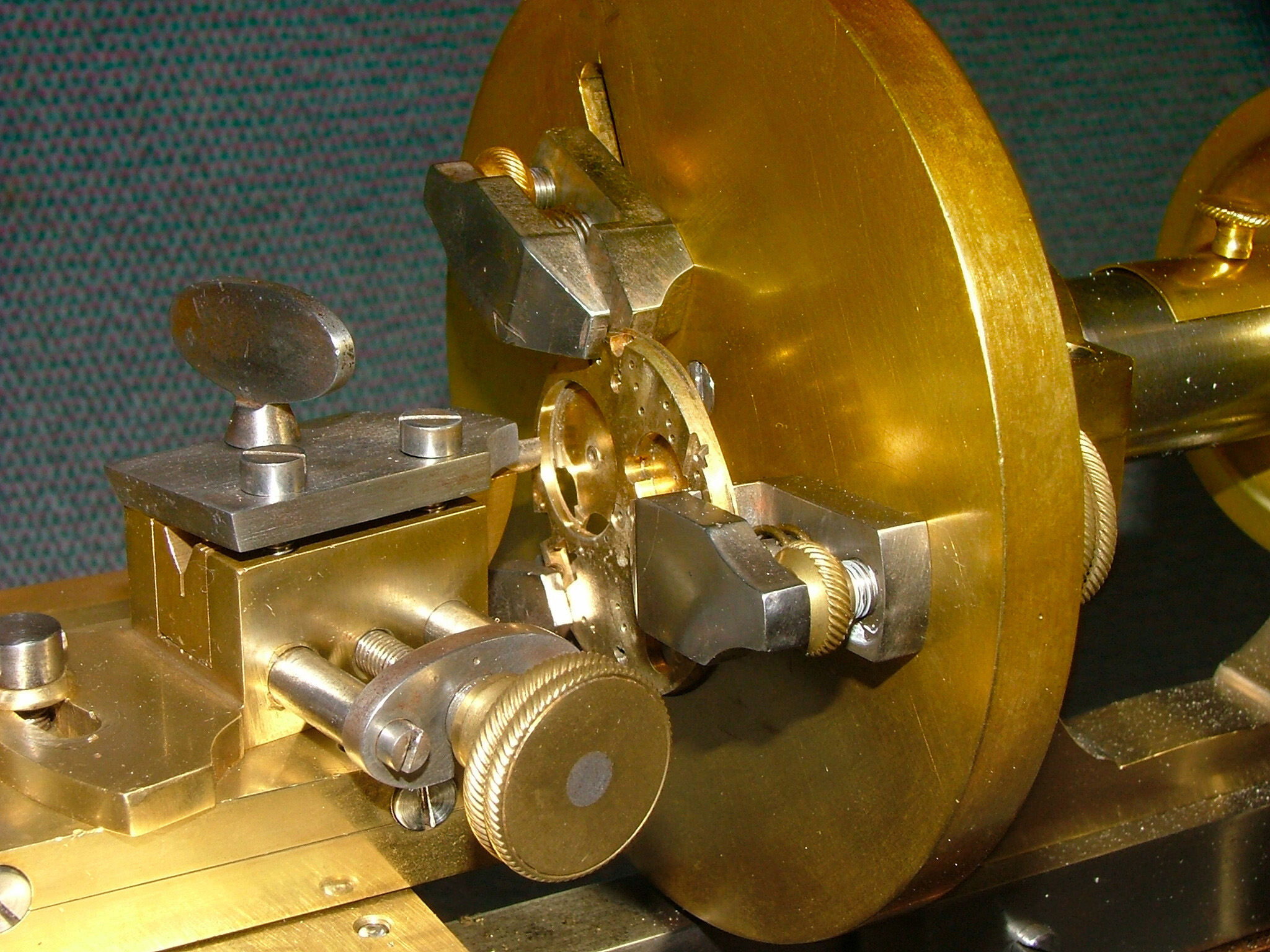

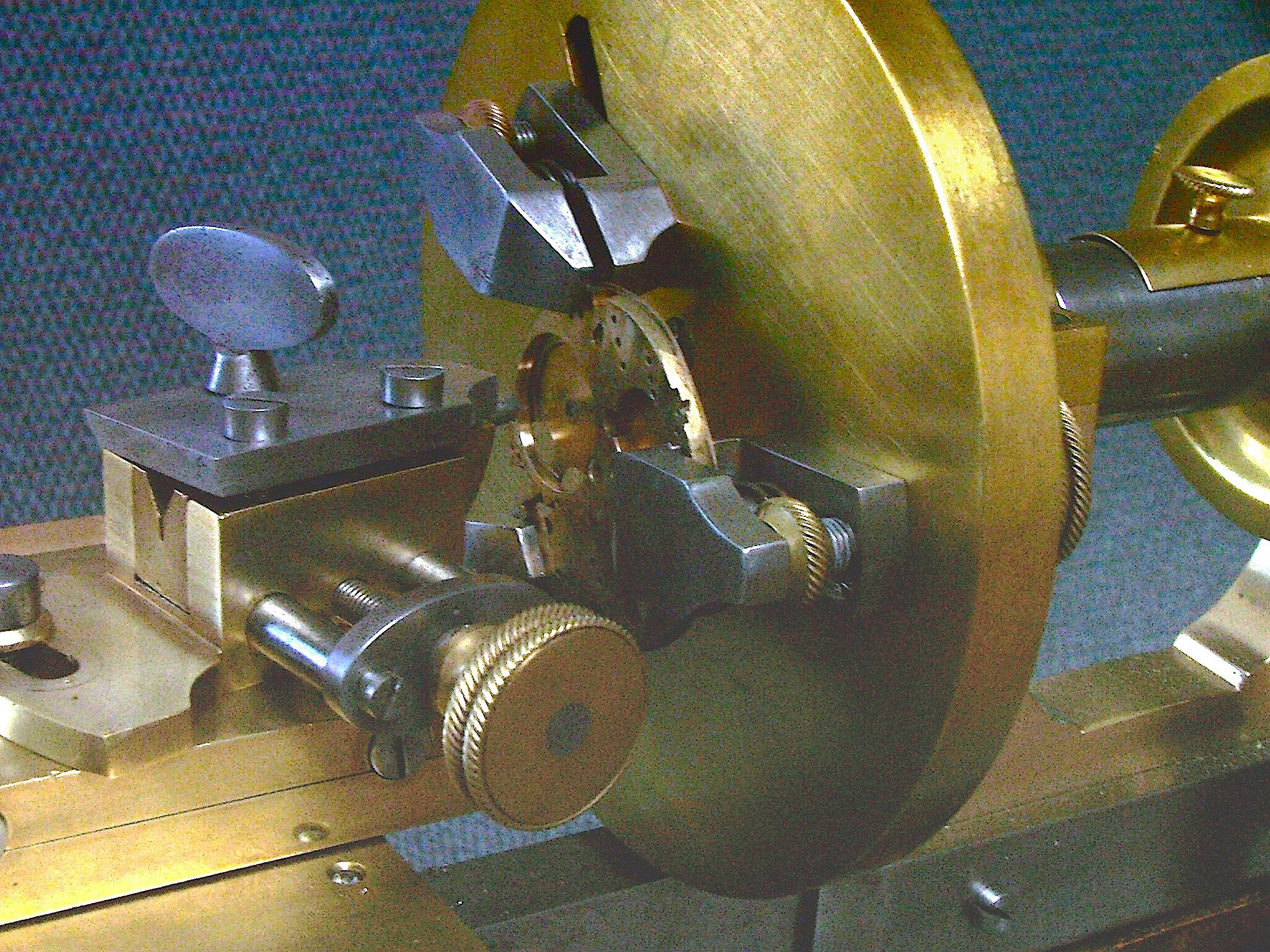

Of a type sometimes referred to as a "mandrel", the "faceplate" was of a type that remains in production to this day for use on watch and clockmakers' lathes. Three radial slots each carried a split clamp with a fine-pitch screw (for precise adjustment), with the centre on some examples carrying what was to become known as a "pump centre" where a workpiece, with a true hole through it, could be exactly centred by using the pointed end of a spring-loaded rod.
