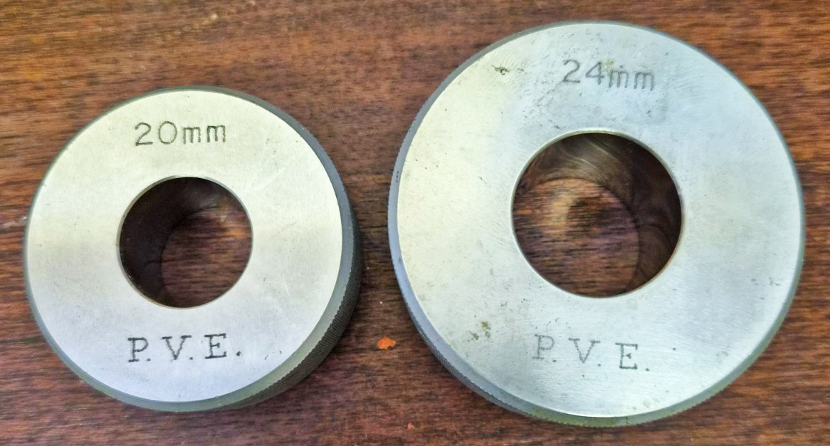

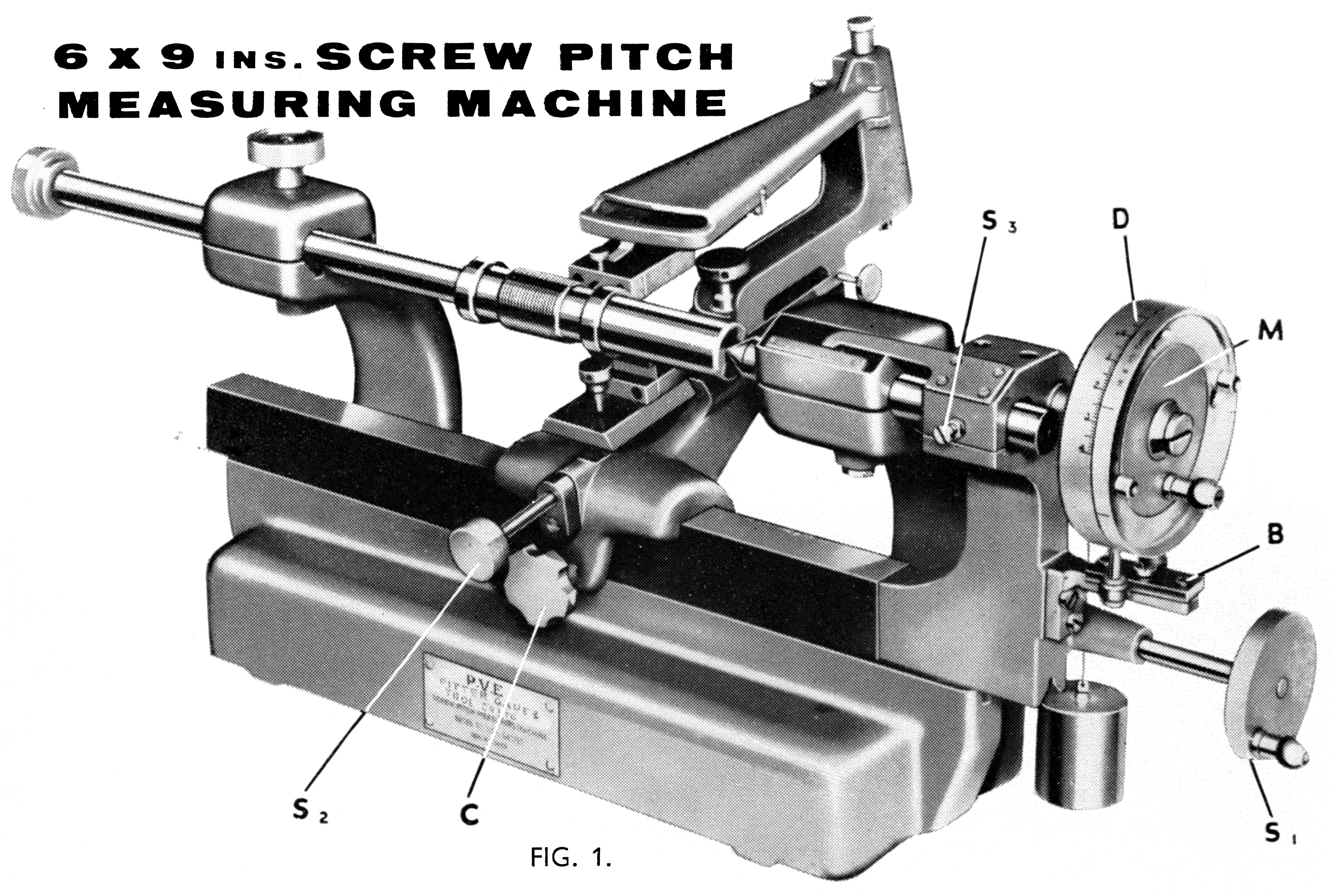

The Company's business concentrated on very high precision measuring and inspection equipment with products including slip gauge (gauge blocks) that were available in various grades e.g. Workshop, Inspection, and Calibration and all available with an NPL (National Physical Laboratory) certificates; thread measuring machines; length bars; screw, plug and special gauges; optical flats; high-precision comparators, and  makers of the Eden-Rolt "Millionth" Comparator that was used to detect wear on slip gauges down to ~1 micro-inch. This was an NPL-designed, mechanical-optical unit with contemporary reports stating that the overall magnification was 20,000× with a replacement threshold of v˜ 30 micro-inch or 3 millionths of an inch (0.00003"). Slip gauges that had worn could be resurfacedand recalibrated (they were, of course, slightly reduced in size) and their new size recorded on a calibration chart, an item that was always supplied with every reconditioned set. If a gauge was too badly worn, it was always replaced by a new one, the maximum amount of wear that P.V.E, recommended being 30 millionths of an inch (0.00003 inch).

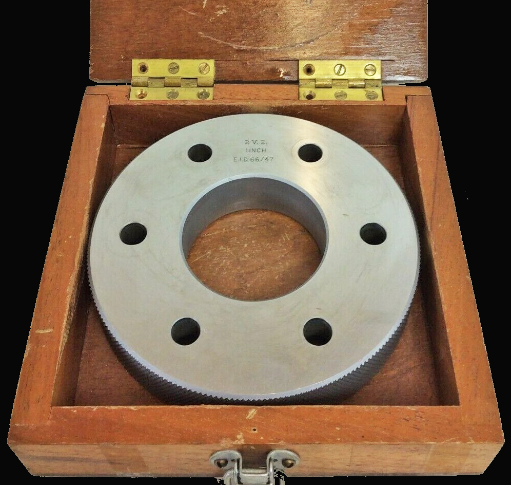

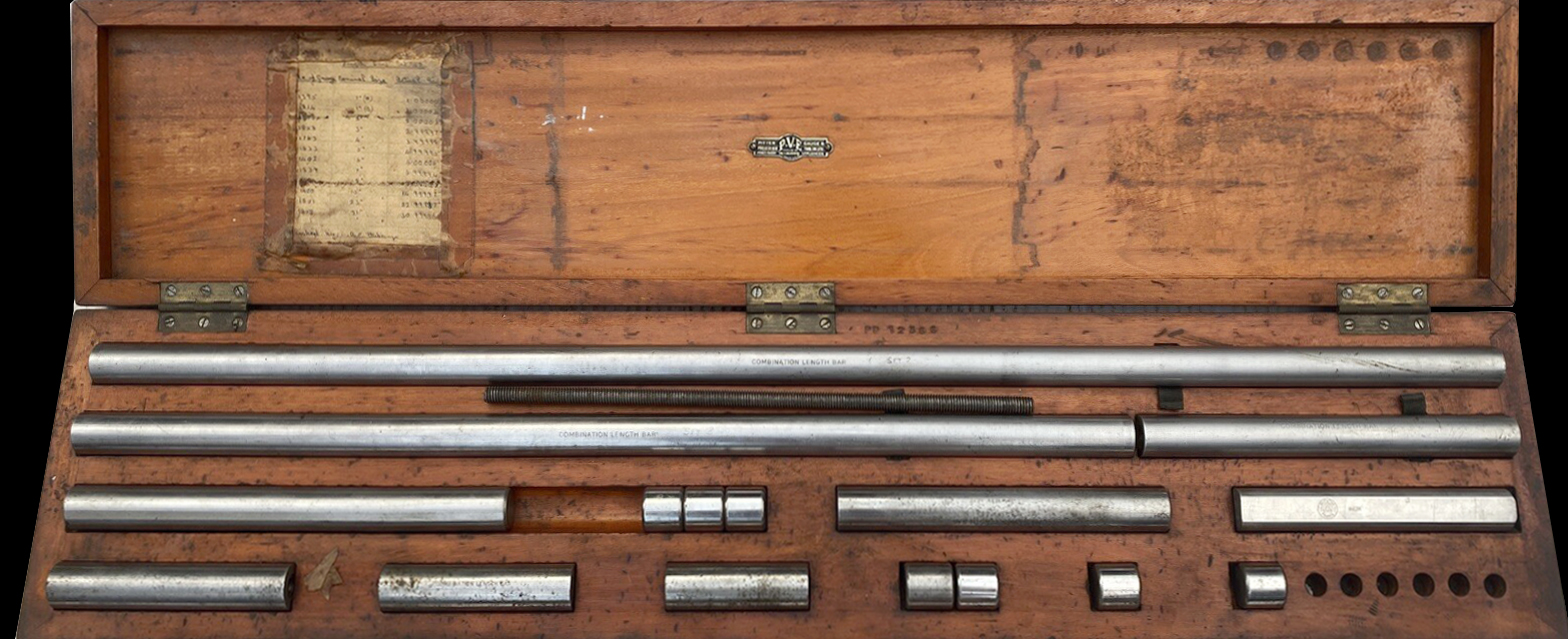

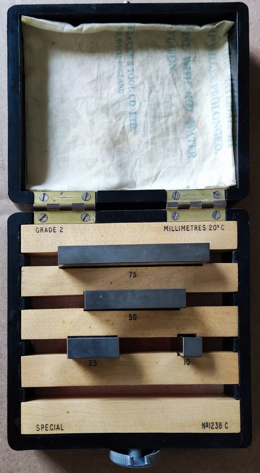

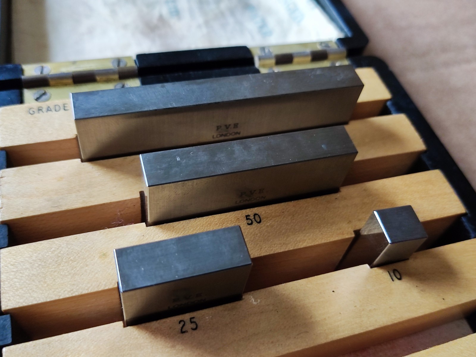

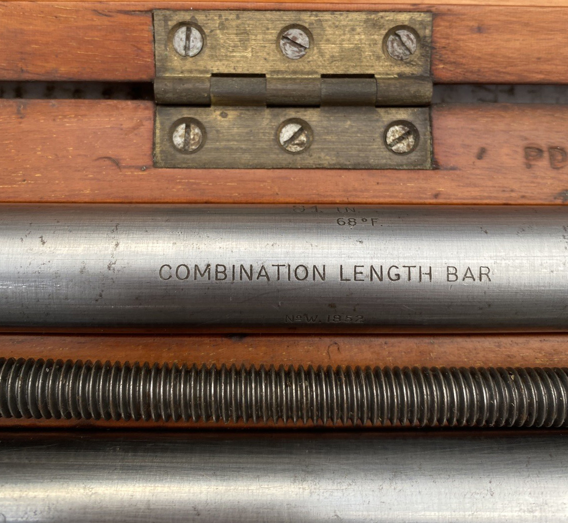

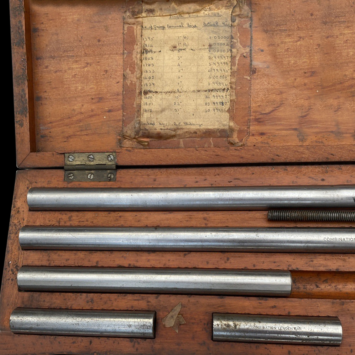

Pitter P.V.E Combination Length Bar Set

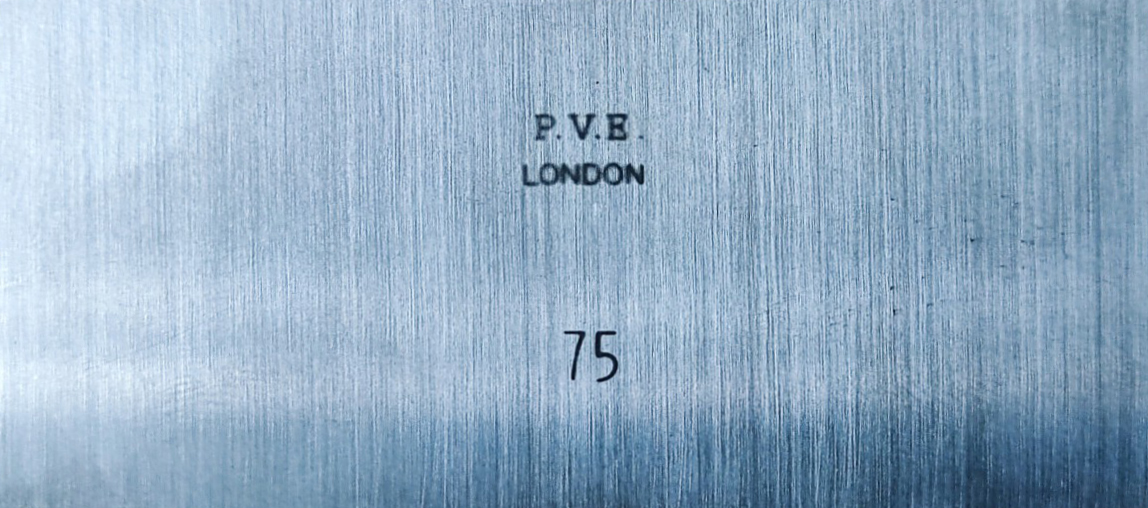

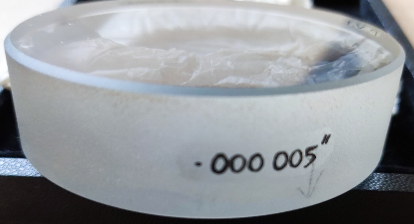

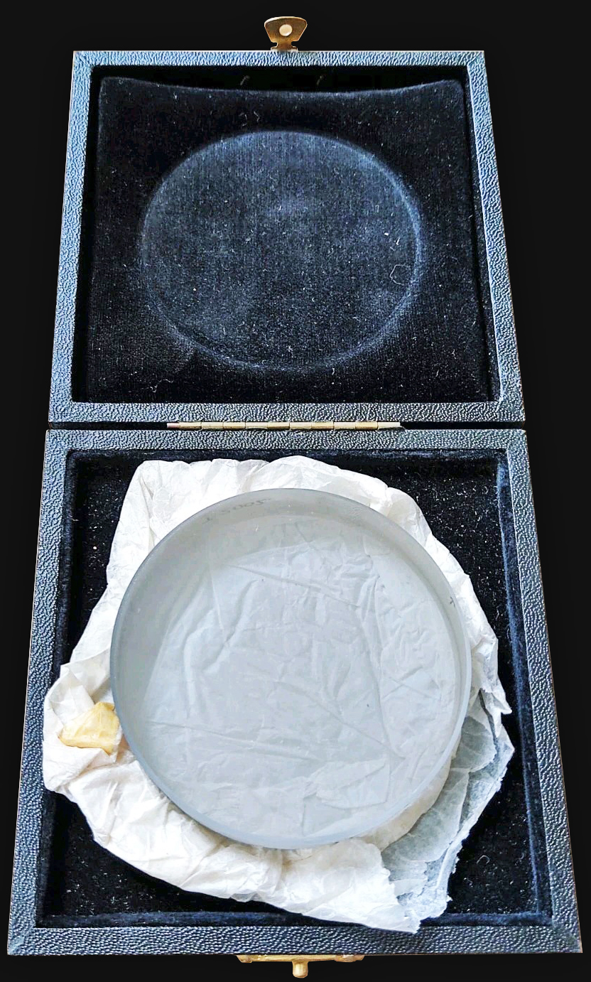

Pitter P.V.E Precision Optical Flat
Pitter P.V.E Precision Length Bar Base, Imperial 1-inch

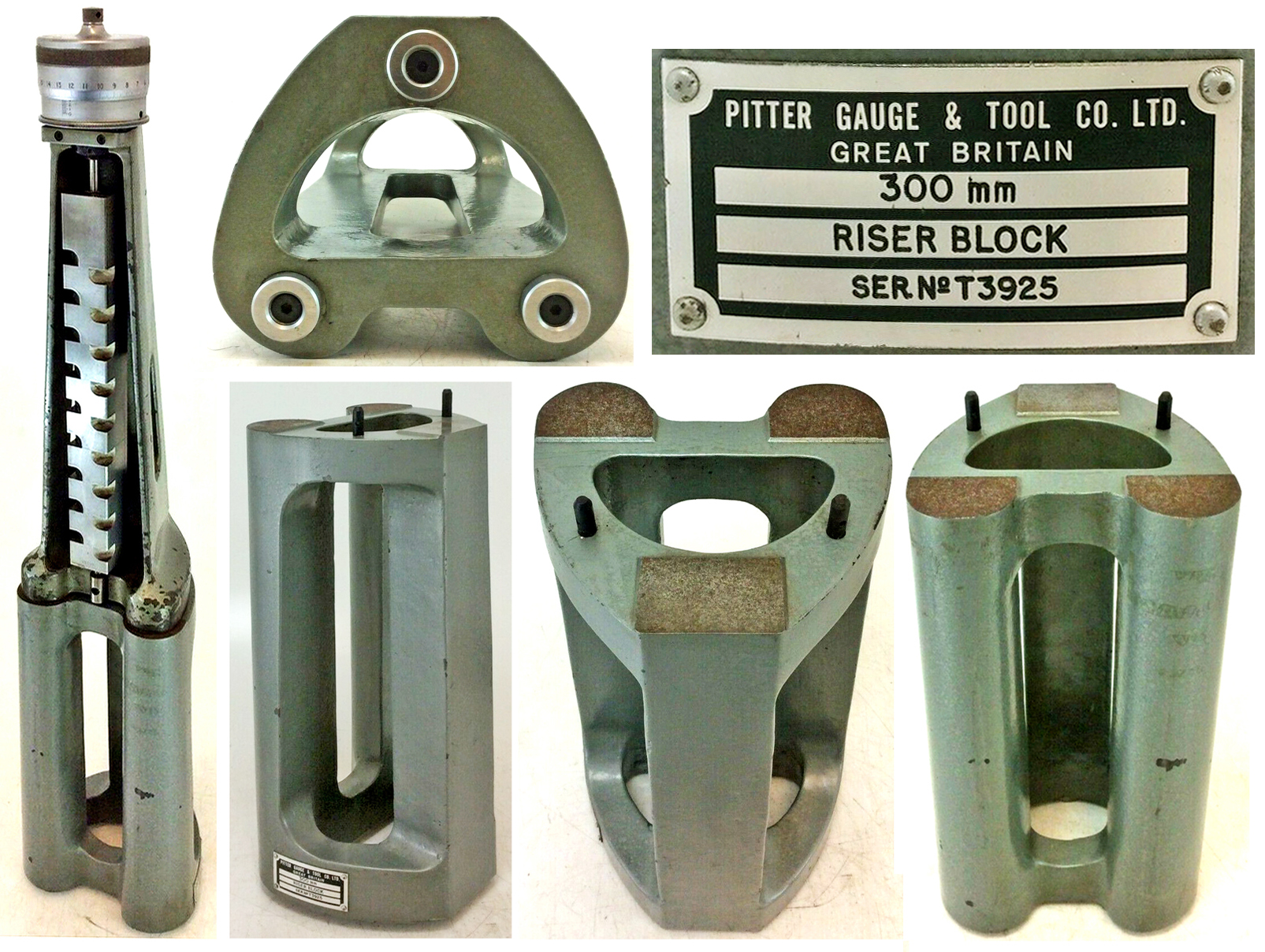

Pitter P.V.E  Height Master on a 300 mm raiser block
