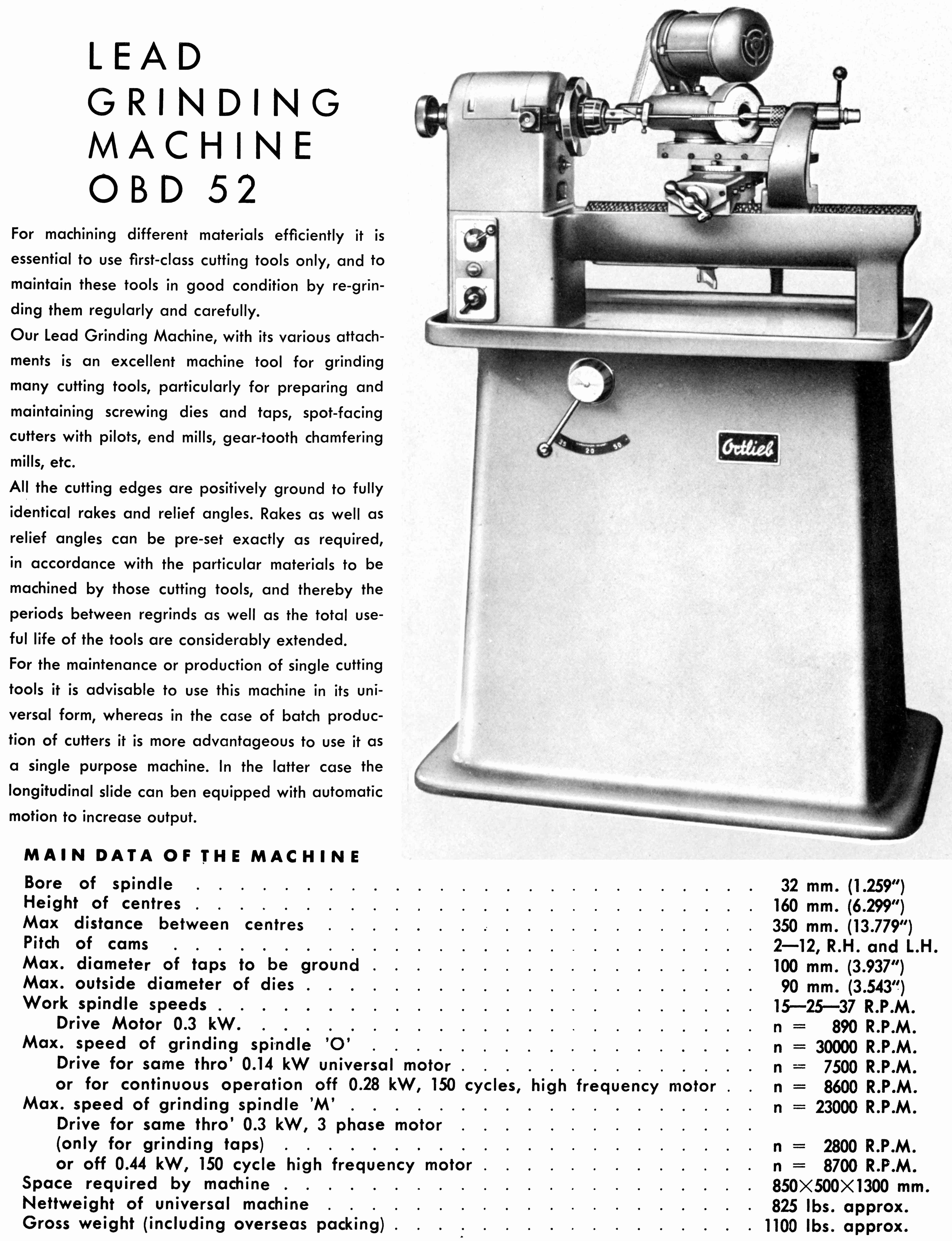

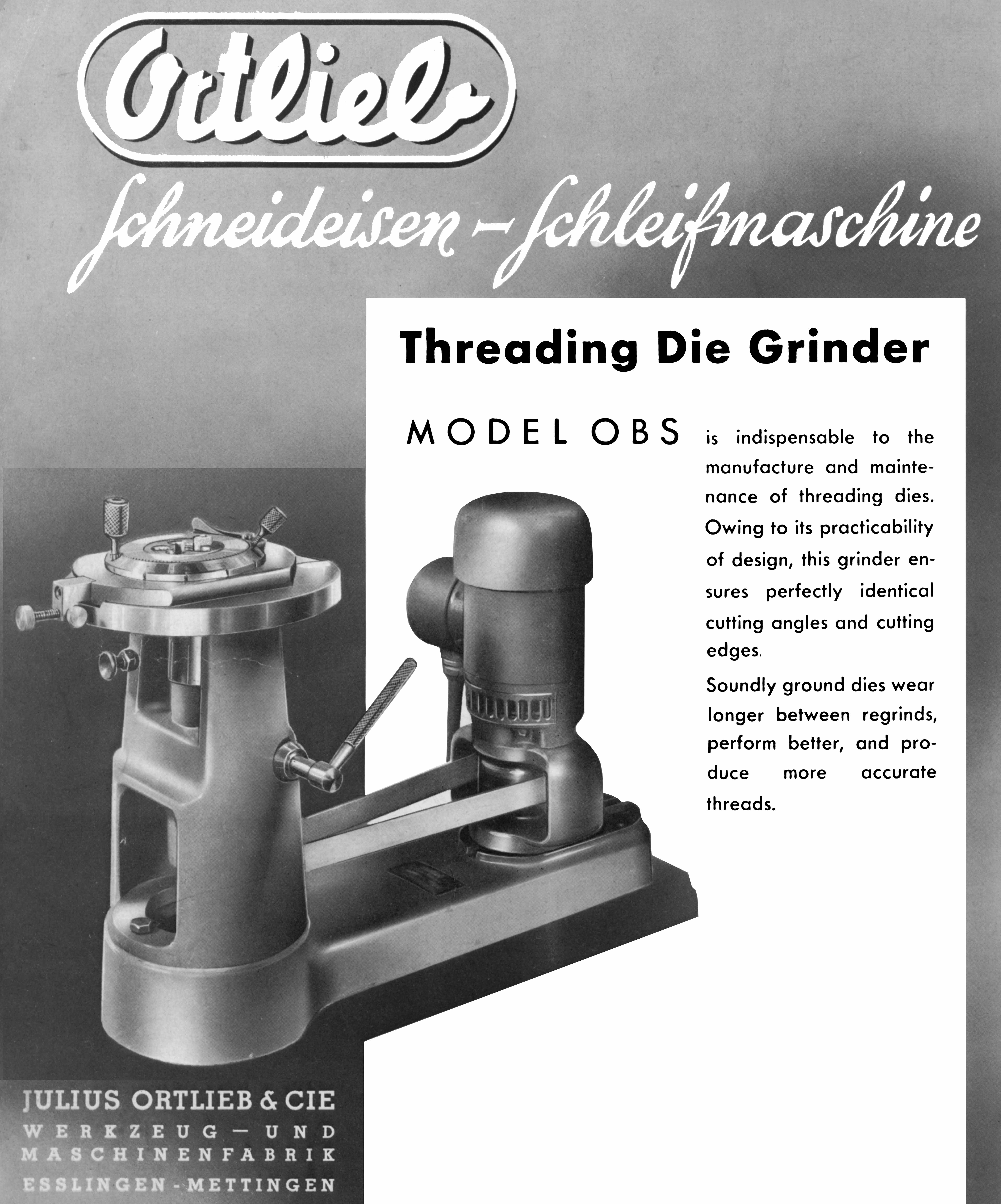

Made by Julius Ortlieb & Cie. Werkzeug-und Maschinefabrik of Esslingen-Mettingen in Germany from the 1950s until the 1970s, these two specialised machines were listed as the OBD52 chamfer grinder and the OBS die grinder. 'Anschnitt' the chamfer or lead (the tapered edge before a thread or cutting edge);
'schleifmaschine' a grinding machine; 'Schneideisen' as in threading die, and 'Schneideisen-Schleifmaschine' a die grinding machine.
