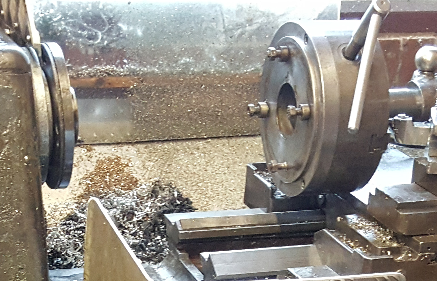

At first - on what appears to have been the just the 7-inch and 7.5-inch models - the spindle-end fitting was of a most unusual quick-release type with the spindle ending in a flange but with a narrow, knurled-edged "thrust plate" fitted immediacy behind it. The flange and plate were each drilled with four holes into which fitted threaded studs on chucks and faceplates; to remove a spindle fitting, the nuts were slackened and the thrust plate rotated slightly to line up the holes - whereupon the fitting could be slid off.

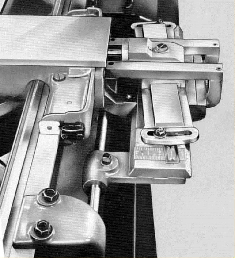

The taper-turning unit was especially well thought out with the unit brought into operation by tightening just the two bolts holding the anchor bracket to the bed and once in use it was still possible to operate the cross slide normally. The scale was marked both in degrees and inches of taper per foot.

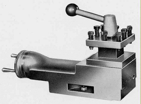

A 4-way toolpost was standard, but the slide to which it was fitted was not T-slotted making changes difficult than they should have been; however, an alternative toolpost, below, included a T-slotted casting.
                         Boring table to replace cross slide                              American-type toolholder that came complete with a T-slotted top
