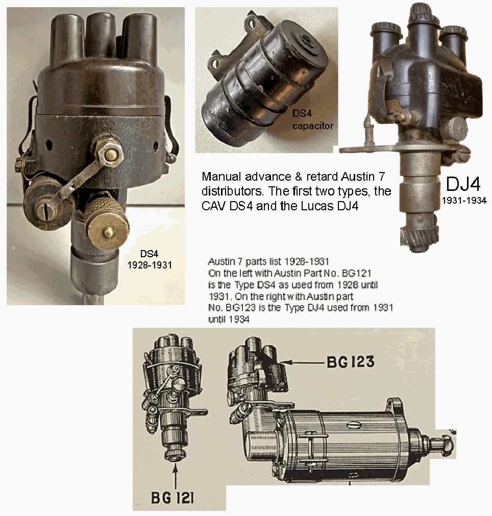

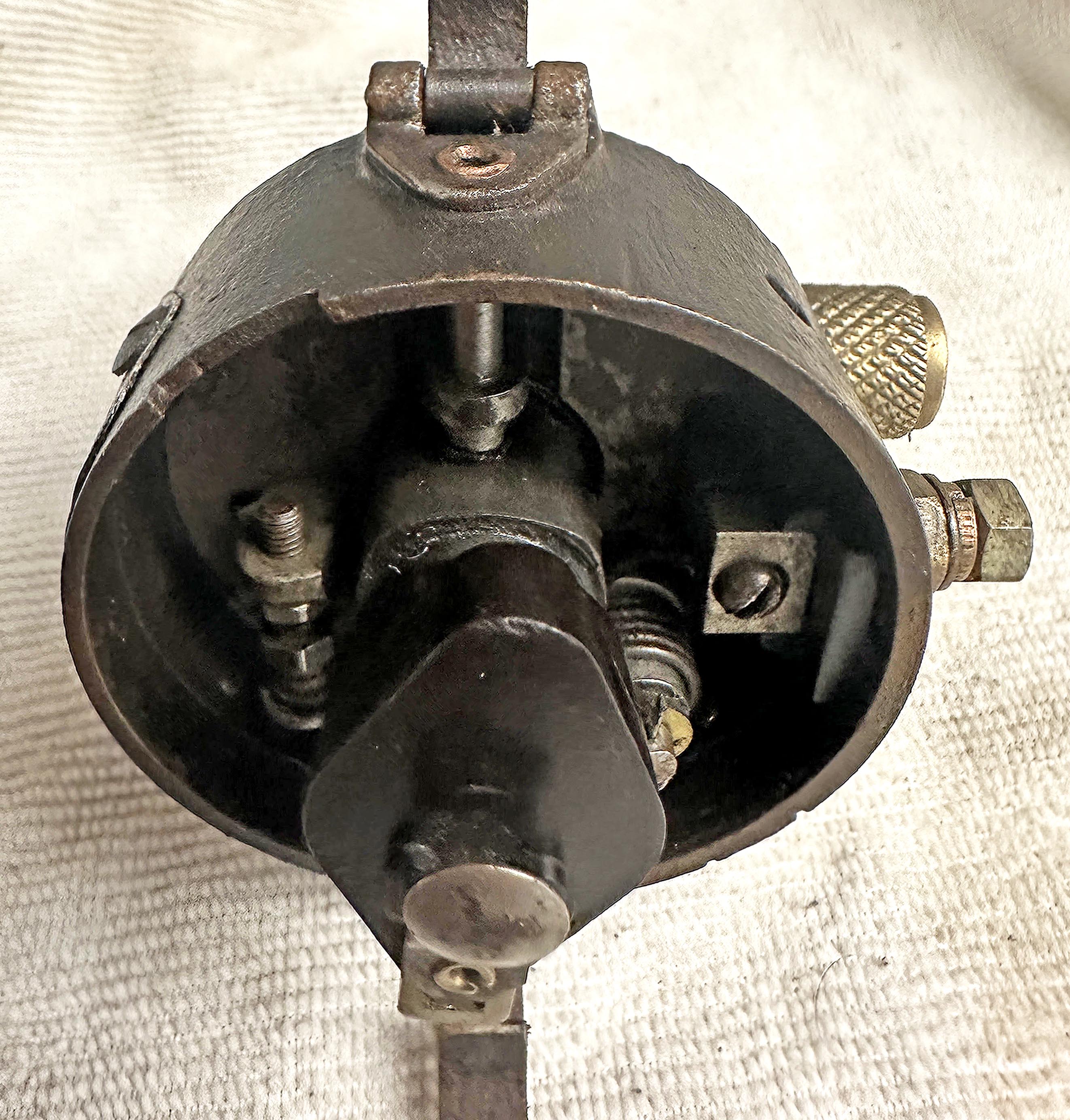

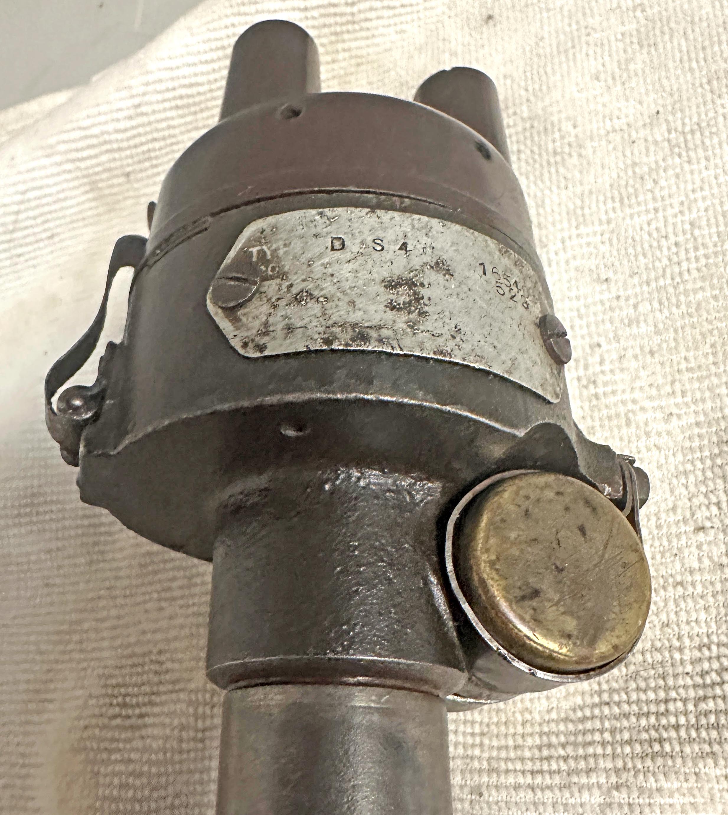

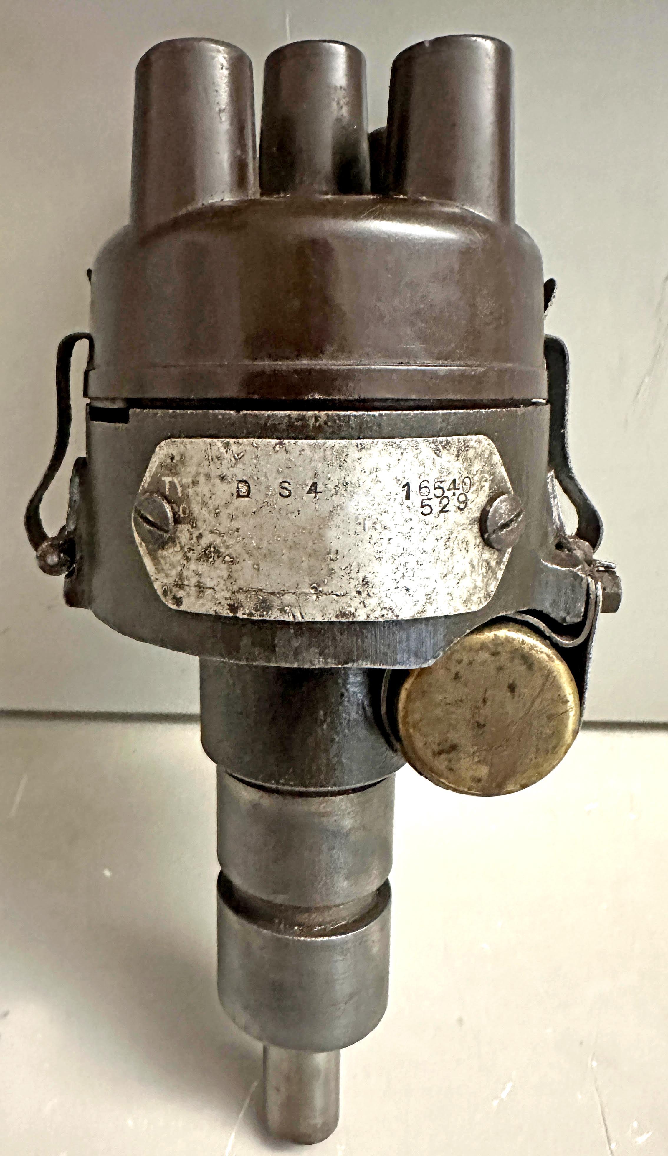

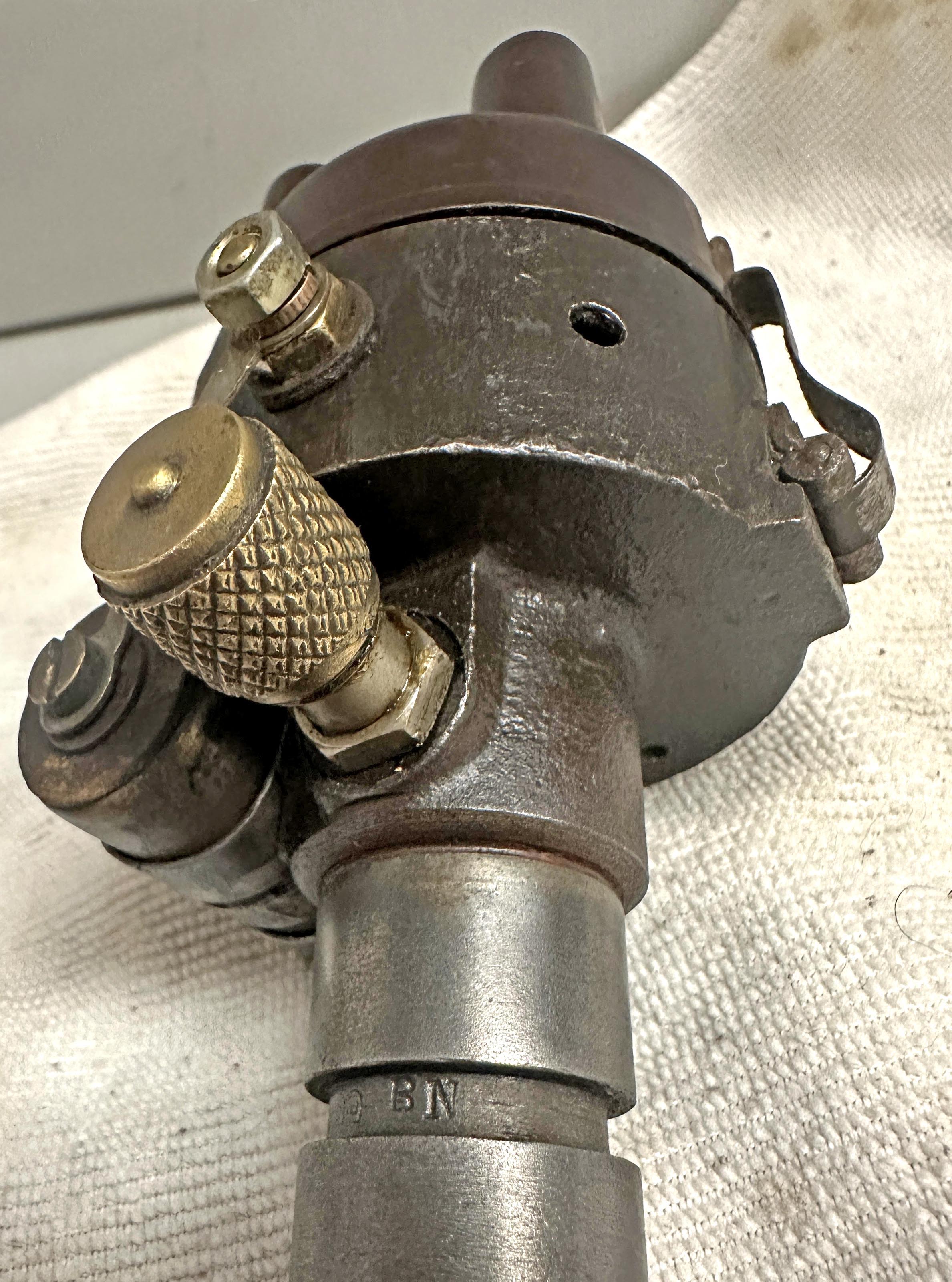

Although now very old, both the early distributors used on the Austin 7, the DS4 and DJ4, can be maintained in usable condition. The earlier DS4, with its deep cast-iron body  must have been relatively expensive to manufacture and its replacement, the DJ4, was a complete redesign. However, both work just as well and if you can get a DS4 back into working order it will perform as well as its replacement.

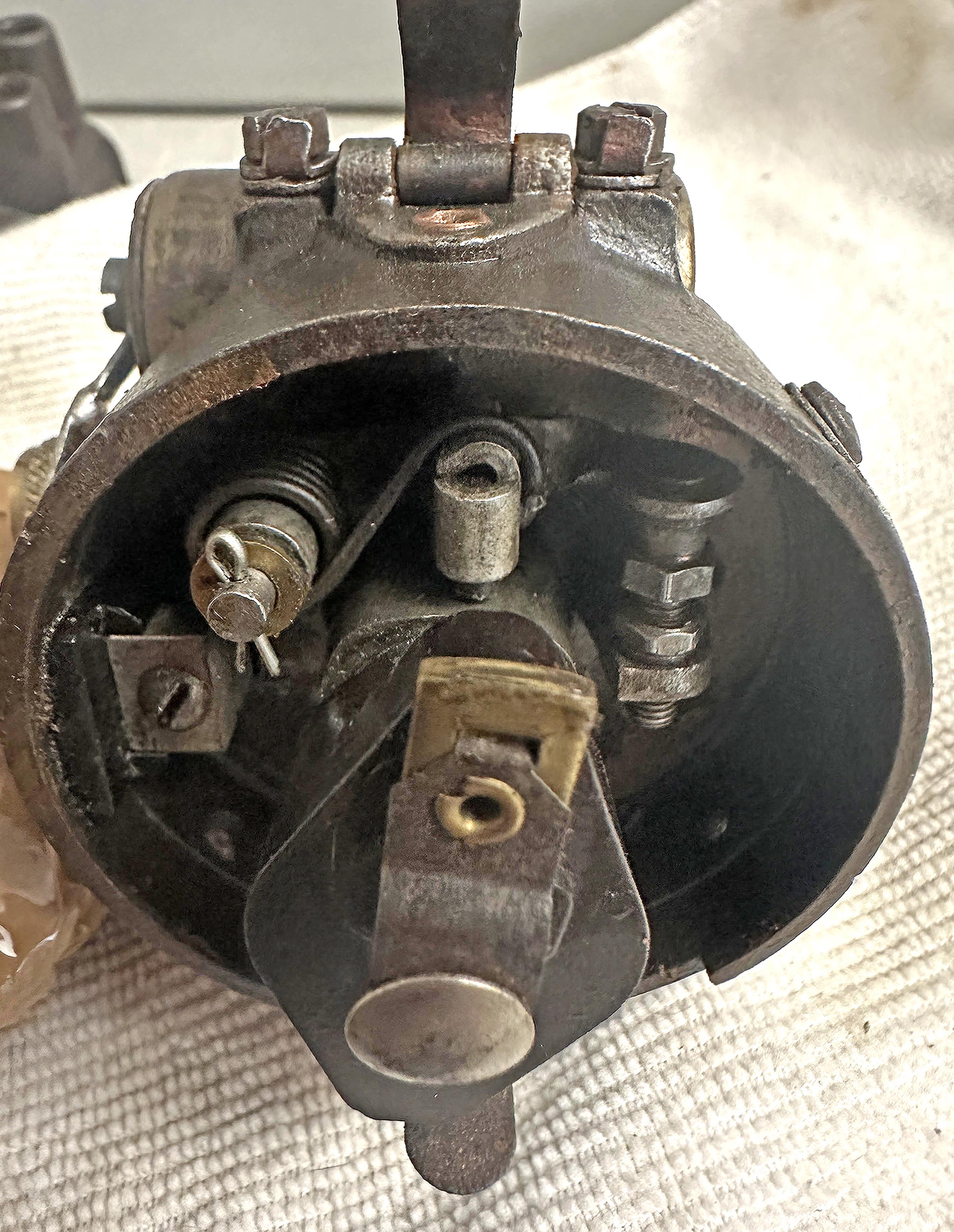

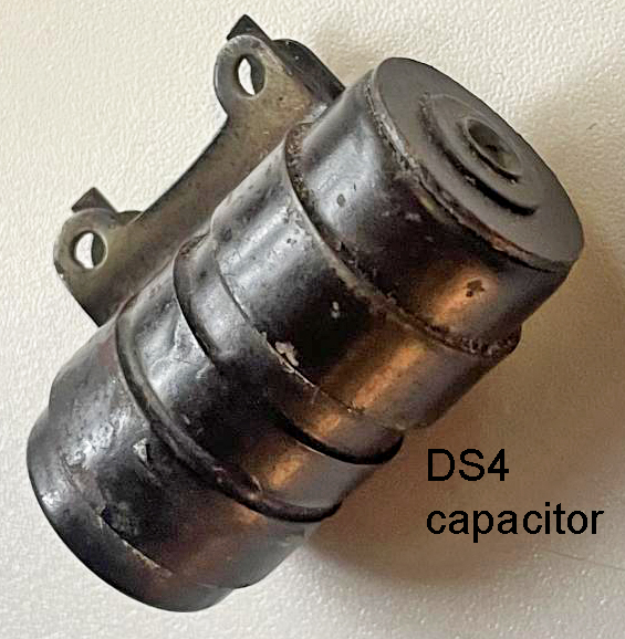

While new capacitors, caps and points for the DJ4 can be bought from several reliable suppliers, they are not available for the DS4. However, with a little time and effort, it is possible to modify other points to fit, and the capacitor is large enough to accommodate a modern replacement inside. The cap for the DS4 can be replaced by one from a Renault Dauphine, and the rotor arm from a Vauxhall Viva HB. It's also possible to convert both to electronic ignition, as a search on YouTube will show.

Unfortunately, almost all reproductions of the original capacitor have been imported from China and have proved to be of a disastrously low quality. If you want to use an original type, buy only from a company with a proven ability to restore distributors to perfect working order - the Distributor Doctor.

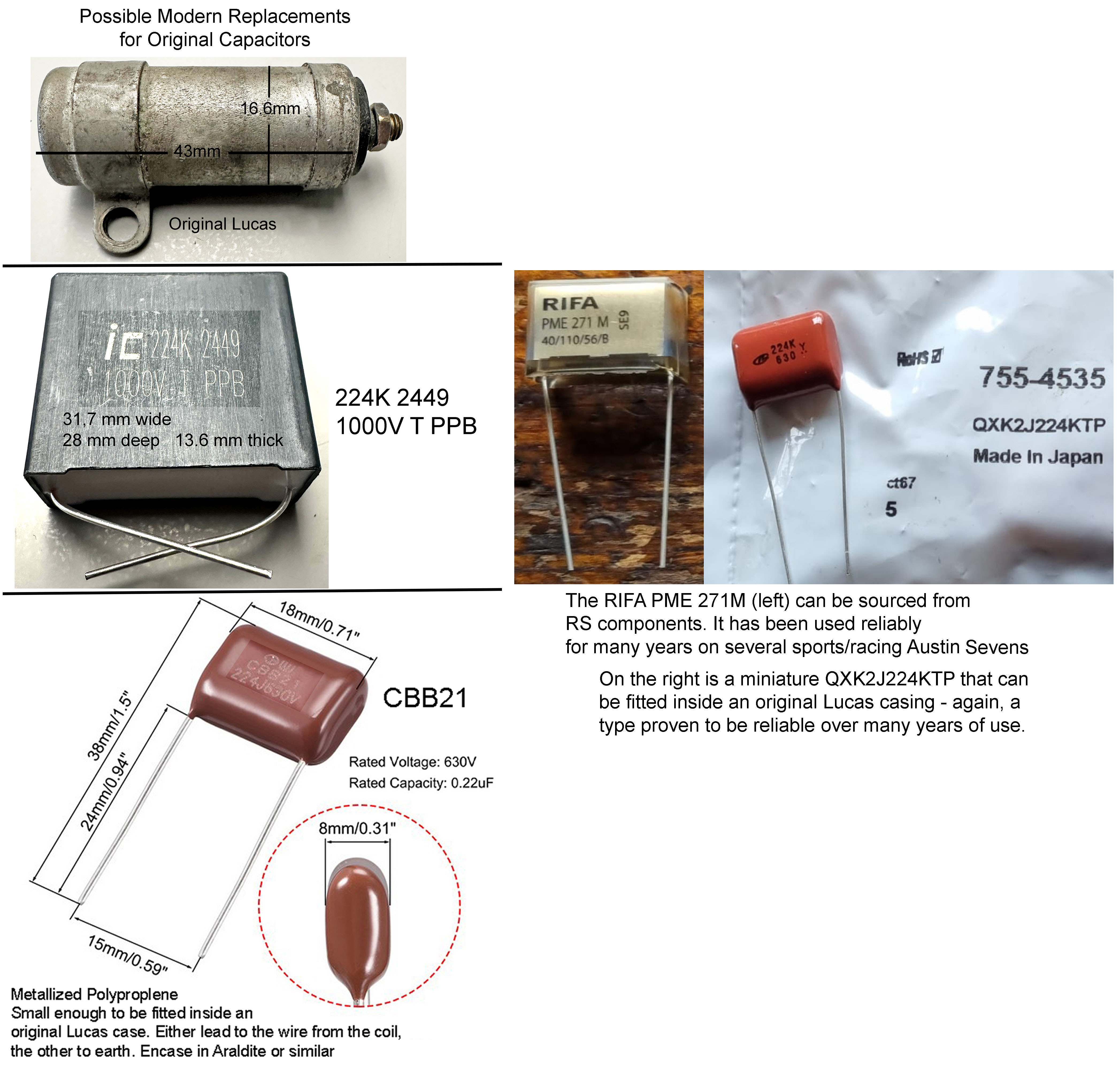

As an alternative to the original type, a modern, highly reliable and competition-proved polypropylene capacitor can be used; some are tiny, while others, too large to fit inside the distributor, can be mounted remotely.
The easiest way to connect a larger one of this type, for example, the 598-224PPB102K or the RIFA PME 271M (available from RS), is to connect one terminal to the coil terminal that goes to the distributor and the other to a convenient earth point. The unit can be hidden under the dashboard, or placed more conveniently, perhaps held with industrial-grade Velcro to the bulkhead beneath or to one side of the coil.
I have one of these capacitors set up as a snap-on spare; it's fitted with flying leads, and terminal ends ready to fit. There is no need to remove the failed capacitor; just connect the new one to the terminal on the coil that goes to the distributor and the other end to earth.
The tiny CBB21 (many sellers on eBay have them) is just as effective and can even be fitted inside an old Lucas capacitor if you remove the original guts. It's a good idea to then encapsulate the new one in Araldite or a similar material. However, with these modern types, it's been noted that when the points open, a back EMF of several hundred volts is generated, and the capacitor should be able to handle this. The 598-224PPB102K is rated at 1000 volts, and the tiny CBB21 at 630 volts; the latter is the minimum to consider. Another option of the latter type is the Japanese-made QXK2J224KTP, a unit proved over long service in many Austin Sevens used for competition and, one more, the Swifttune, another motor-sport-proven unit.

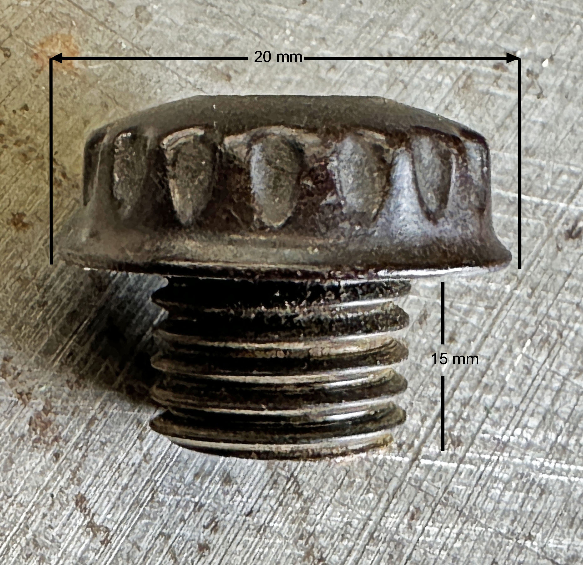

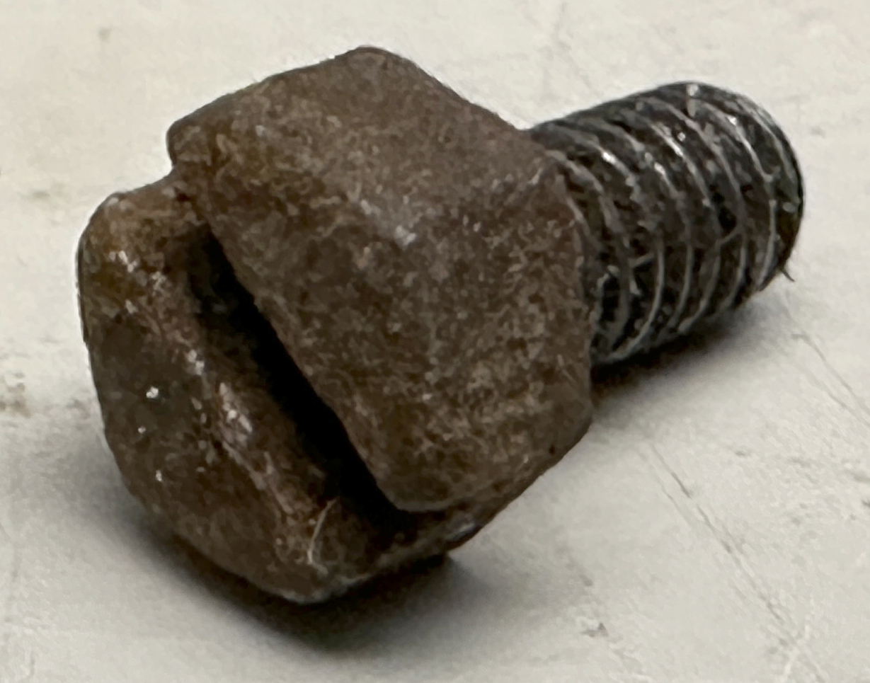

The two screws that hold the condenser on are in steel with a 5BA thread and of a very rare type - they have a hex head and screwdriver slot.
You can buy ones that need a slot cutting here:
https://www.chronos.ltd.uk/product-categ...e-ba-bolts
and here: https://www.ebay.co.uk/str/maccmodelengi...&_tab=shop
amd here: https://www.ba-bolts.co.uk/steelba.html

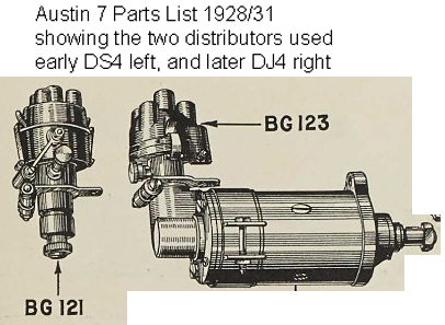

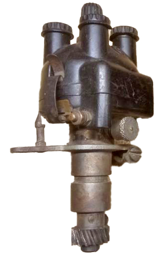

The DJ4 as used from early 1931 until the advent of the automatic advance and retard DK4 in 1934

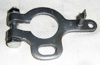

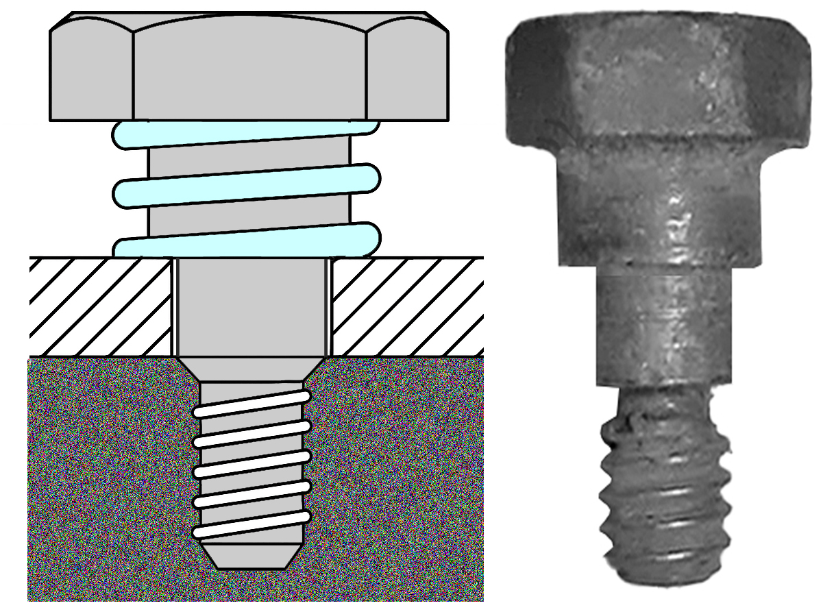

Both the DS4 and DJ4 where secured to the dynamo body by a special two-diameter bolt. The bolt could be locked down tight, but this did not lock the distributor, instead a spring wrapped around it upper diameter allowed the distributor the freedom to be rotated by the hand control in the middle of the steering wheel. The system allowed a little vertical place in the assembly with the drive gear on the end of the drive shaft being to move away from its central location against the dynamo spindle mounted drive gear. This this does not seem to have affected the  performance of the ignition system.

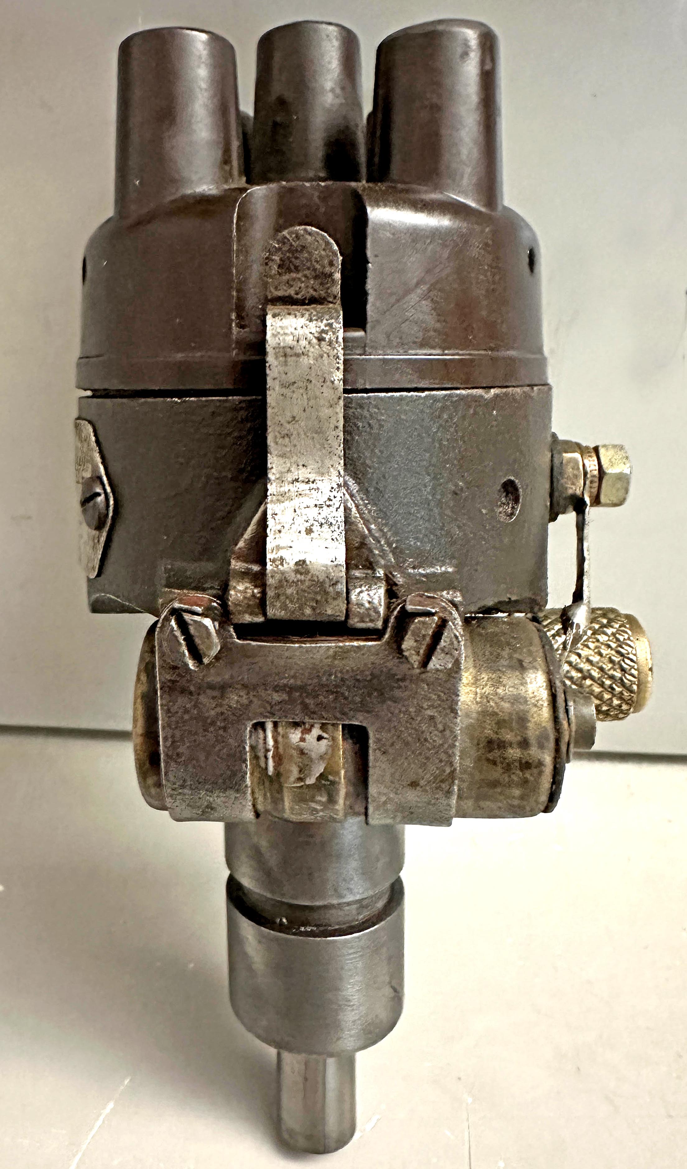

The clamp that fastens around the distributor shaft. The slotted hole is the one through which the two-diameter bolt passes. The adjust the ignition timing, the clamp is slackened allowing the distributor to be tuned before the clamp is once again locked tight

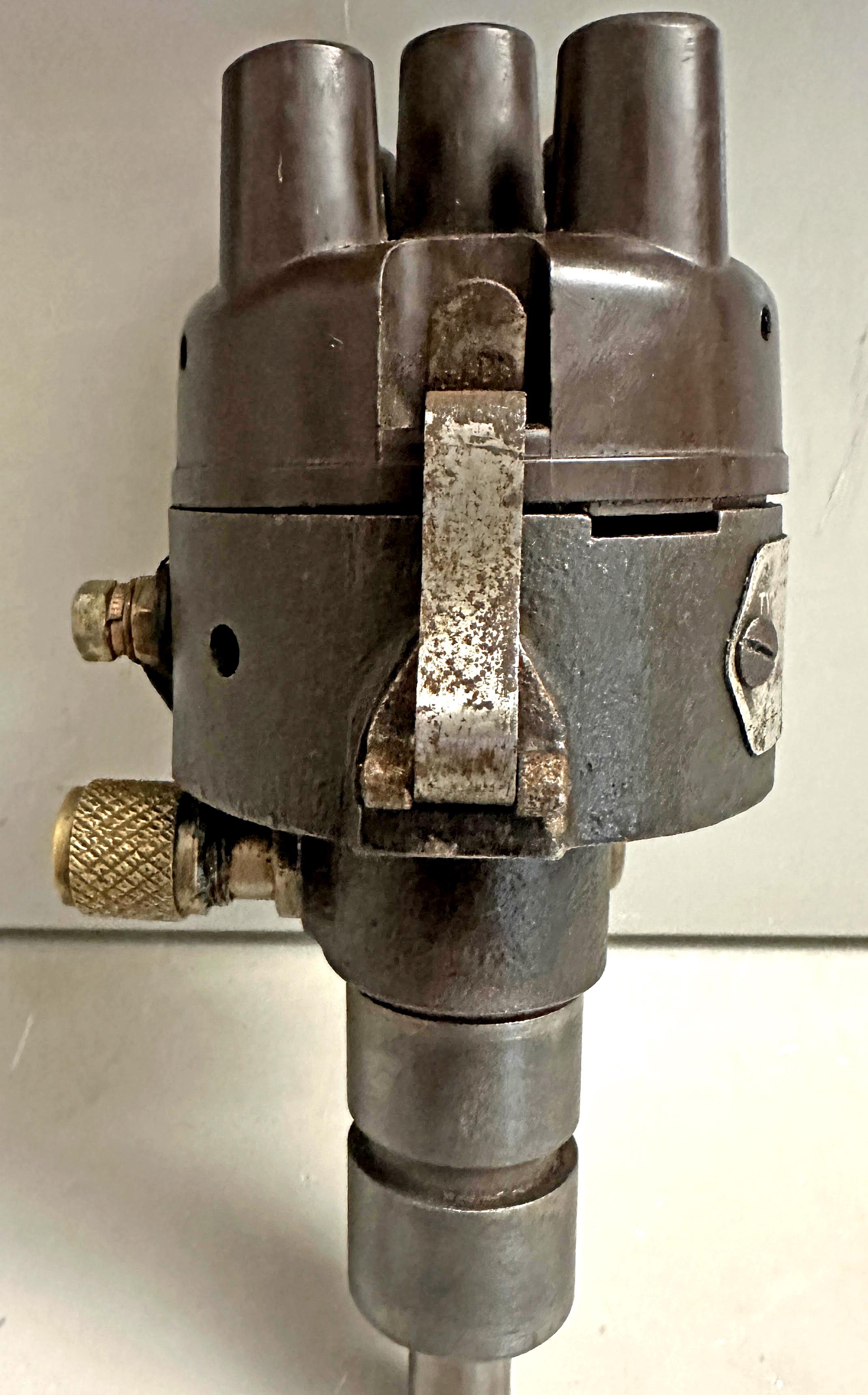

While the DS4 had push-in HT leads, the DJ4 used screw-down caps. Both the cap and the 'mushroom-headed' retaining screws were brown
