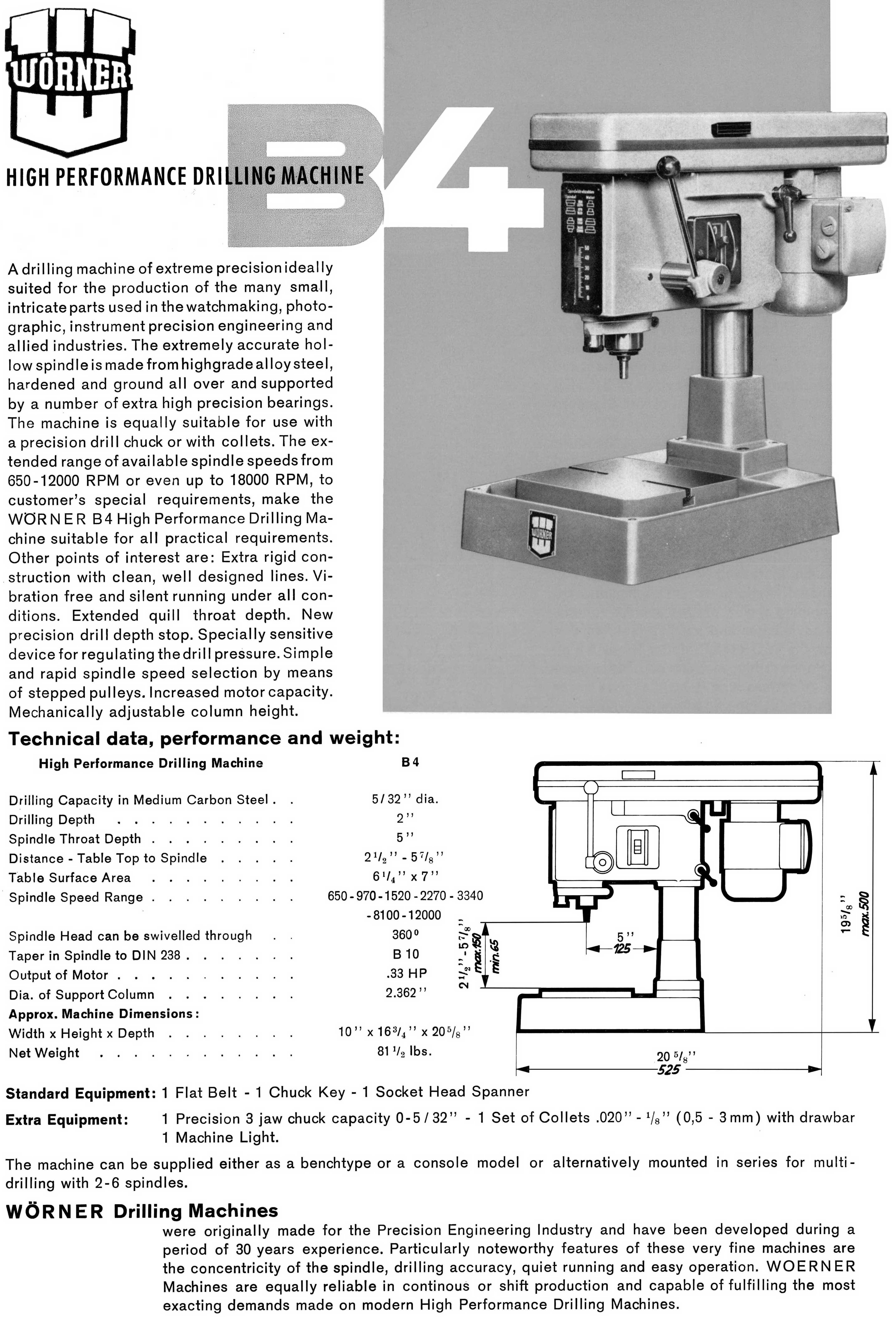

Later models included the B4 and B8 (these are shown below with full details of their specifications) with data about BG8, B13 and BG16 as yet unknown. All were intended not for general workshop use, but for industries such as watch and clock making, the production of photographic equipment, mechanical instruments and similar items.

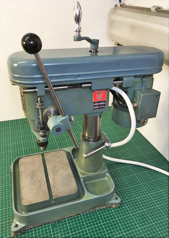

A beautifully restored and fully functional Wörner of an early TIBO 6. The story  of its rebuild
With photographs showing the high-quality of its construction can be found here
