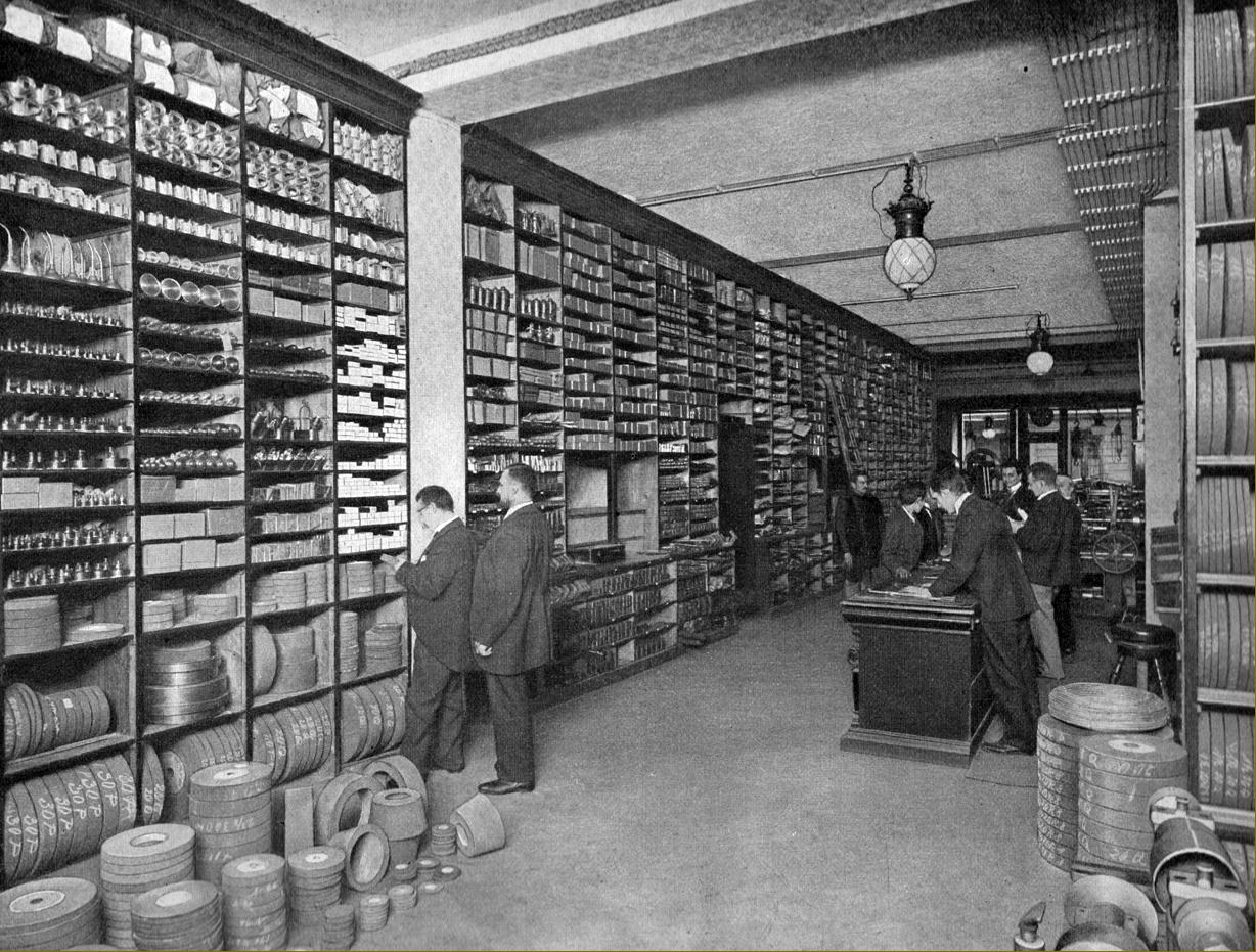

Inspection and measuring equipment, chucks, files, saws, tap & die holders, etc. and, in the mid-ground, an American Rivett "8-inch Precision" lathe

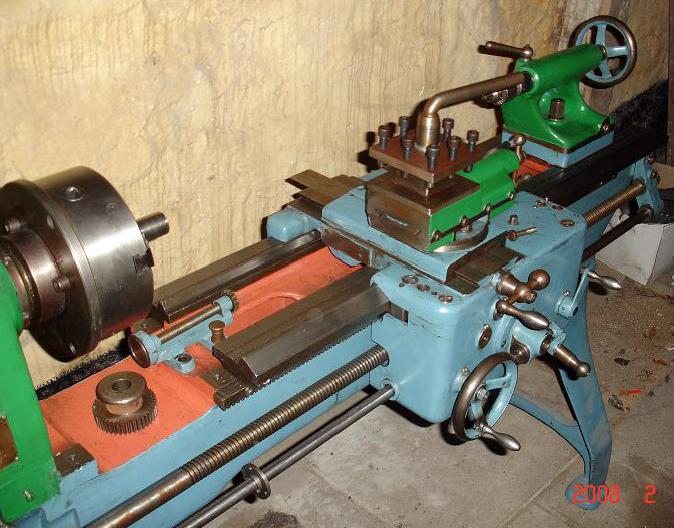

Founded in 1880 by Alfred H. Schütte, Schuchard & Schutte began life an importers before moving to machine-tool production in 1915. Still run as a family firm, in the early years of the 21st century the managing partner is Carl Martin Welcker, the founder's great-grandson. Now well known for their multi-spindle automatics and 5-axis CNC grinding machines, previous decades saw the production of tool and cutter grinders (for which the Company has long been famous),  multi-spindle automatic and a range of conventional backgeared and screwcutting lathes such as the one below. Looking like a typical design from the 1930s, the gap-bed machine has a centre height of around 7-inches and 30 inches between centres. Heavily built and fitted with a screwcutting gearbox, the sliding and surfacing feeds are driven from a separate power shaft. The carriage assembly is particularly massive - particularly the apron, fitted with a positive, quick-action power-feed engagement mechanism. From the general appearance it is likely that a geared-head version of the lathe was also made.
