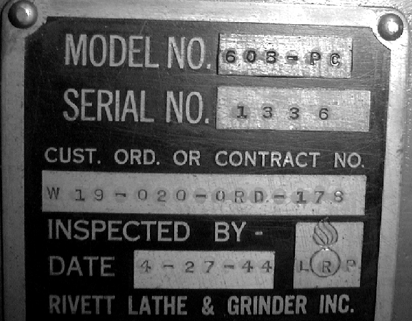

The maker's Serial Number and Data Plate for April 27th 1944

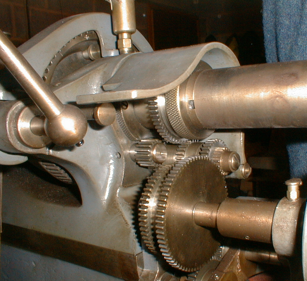

Rear view of the sliding main-spindle gear and the drive down to the screwcutting gearbox. The large gear keyed to the headstock spindle can be moved through three positions to drive the carriage right or left - or put the gears out of mesh completely.
