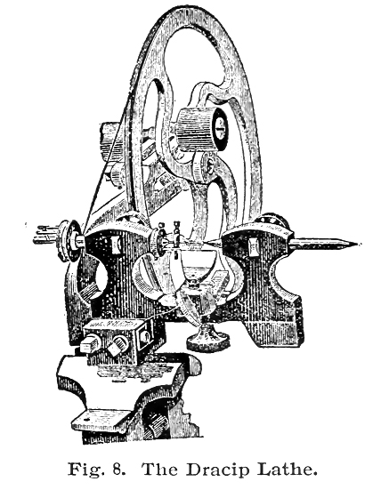

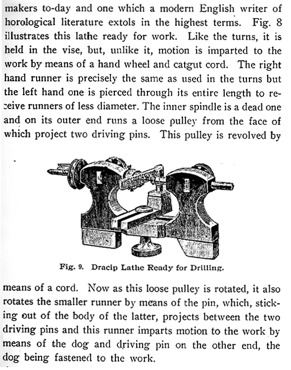

I don't know if Henri Picard & Cie were makers of lathes but I think their relative, Theodore Picard, was the one who created and produced the Dracip lathe that you briefly describe in your website.
"Dracip" is the anonym of "Picard", and Theodore used it not only in the lathe, but in their watches.
For more information about Theodore Picard: https://www.judaisme-alsalor.fr/synagog/hautrhin/g-p/hegenh/horloge/tpicard.htm
I found these facts (or just clues?) while searching online for some photos of the Dracip lathe. It seems they were quite popular in their time but I have not been able to see one, just these two illustrations:
