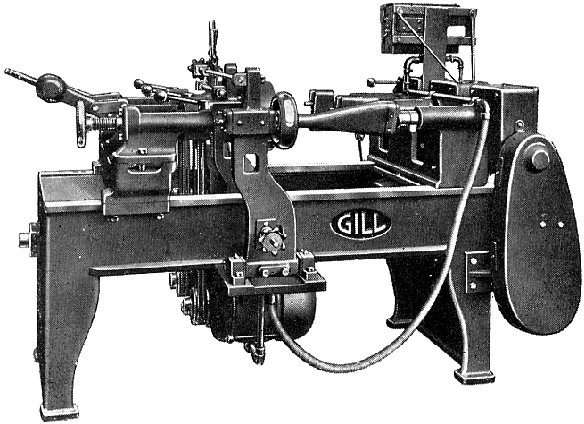

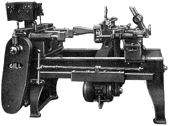

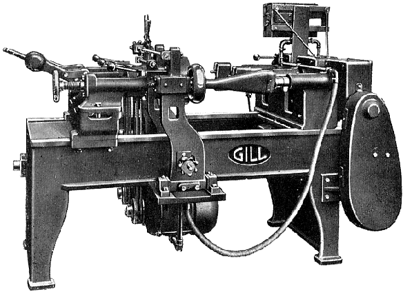

Above and below: Oliver No. 102 Double Automatic Copying Lathe. Originally part of the Gill Company product line, this machine was added to Oliver's catalogue in January, 1951.
