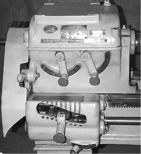

Oliver 14" Geared headstock and screwcutting gearbox detail.
