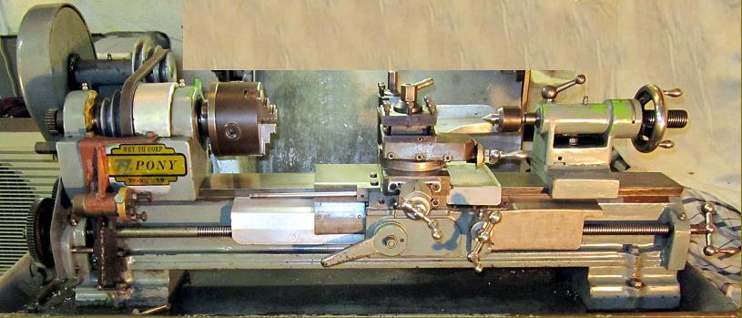

Like other Myfords the ML10 was cloned - one version (illustrated below) being sold in the UK by the long-established importer of Far Eastern machine tools, Warco, and another, perhaps only sold in Australia and New Zealand, badged "Pony".

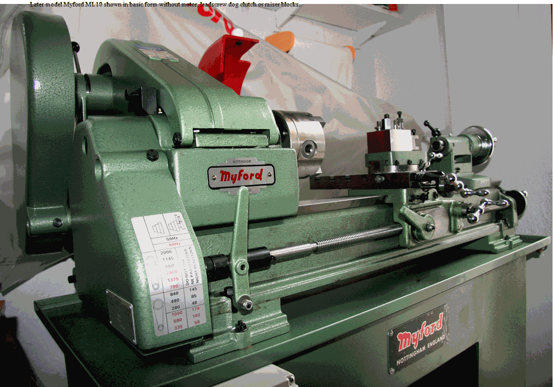

Late model, roller-bearing ML10in basic form without motor, leadscrew dog clutch or raiser blocks.

Made by the Wey Yii Corporation, this Chinese ML10 clone was sold in the UK as a Warco
The same Chinese copy as sold in Australia. When purchased, the customer was faced with a number of difficulties for, as supplied, not a single item for screwcutting could be assembled, the changewheels studs were too short (though 22 gears were provided instead of the basic 13) and the banjo would not mount on its bracket. The backgear refused to engage and the pivot for the countershaft bracket, being positioned inside the drip tray, made the backgear safety cover interlocked & unusable . Luckily, the owner had started an apprentice as a toolmaker and managed to sort everything out. When running the machine provided good service and undertook production work for many years with the unhardened bed taking a good polish but showing no signs of wear.

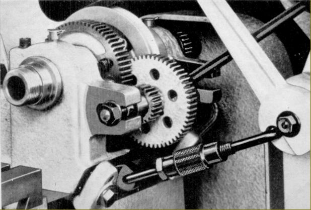

Simple slide-in backgear (just like the pre-WW2 Myford ML2
and ML4
) and the left-right threaded belt tensioning rod
