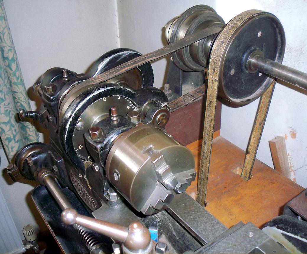

Two short feet, close together in the centre, supported the 6-inch wide, V-edged straight bed (no gap option was listed) and were bolted to either a low, cast-iron sub-base (with a heavy steel chip tray sandwiched between) for bench mounting (which would have accounted for some of the weight) or a very heavy "trumpet-style" floor stand.  When mounted on the latter the total weight rose to 520 lbs and earlier models must have been even heavier still for on those, help between stand and lathe, was a thick cast-iron plate that carried a massive countershaft (with self-aligning ball-bearing) and, slung beneath it, an electric motor. The countershaft mounting holes were slotted to permit belt adjustment and also allow the rather clumsy but very comprehensive belt and backgear guarding to be aligned. Later models (as illustrated below) were, thankfully, simplified and used a more conventional arrangement with the countershaft fastened to the back of the lathe bed or supplied with a separate countershaft, two hangers (with double-row bearings) and a suitable belt-shifter.
Bored through 13/16", the ground-steel spindle was ran in bronze bearing each 2
1/2" long with the front 13/8-inches in diameter and the rear 13/16". Although of the simple, split-parallel type the bearings were, for the size of the lathe, of generous dimensions and provided (at least on some versions) with spring-loaded wick-feed oilers which took their supply from large reservoirs built into the front of each bearing housing; a thoughtful touch was to provide these reservoirs with drain plugs so that the oil could be changed.
The spindle was driven by 1-inch wide flat belt that ran round a 3-step pulley - the largest diameter of which was 5 inches and the smallest 2
1/2". The countershaft of later models of the fast-and-loose type, driven by a 1 3/8-inch wide belt and designed to run at 350 RPM. This gave a speed range, including the 6.25 : 1 ratio eccentrically-mounted backgear, of approximately 28 to 700 rpm. Although not mentioned as an option in the catalogue it is possible that some lathes were supplied with V-belt drive; several survive in such a form and the quality of engineering leaves no doubt that these were a factory job.
