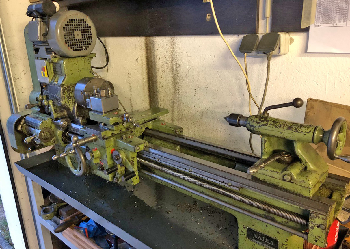

Having profited quite a number of times from your lovely archive, let me (again) return the favour by sending you a few pictures and the background to a very weird "German" lathe. What you are looking at in the pictures below is a German-made Matra MDR2 (civilian) or MDR2A (army or, in this case, the "Armee" model) with MDR2 standing for "Mechaniker Drehbank 2".
Depending upon which account you believe, production started either 1947 or 1949, just after the end of WW2. The lathe is, in essence, a mildly altered

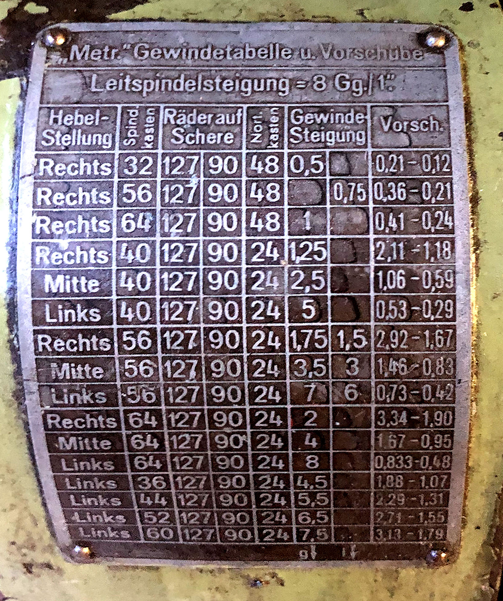

LeBlond Regal 12-inch of the 1940s to 1950s type but with a metric M33x3.5 spindle nose and metric top and cross feed dials. It sports an 8 t.p.i. leadscrew, but (I suspect) unlike the LeBlond, came from the factory with a set of driving changewheels that included transposing ones to allow the screwcutting gearbox to generate for both imperial and metric pitches.
So, why a German copy of an American lathe? Right after WW2 the to-be-founded German Bundeswehr found itself in the possession of a plethora of US-made tanks, most of which had been "well run in", i.e. were in constant need of maintenance. Thus ,every tank company/battalion was equipped with maintenance trucks. These trucks had, among other things, the Matra MDR2A lathes installed in the back in order to machine all the various imperial bits and bobs (definitely a technical term �� ) that are to be found on such vehicles.

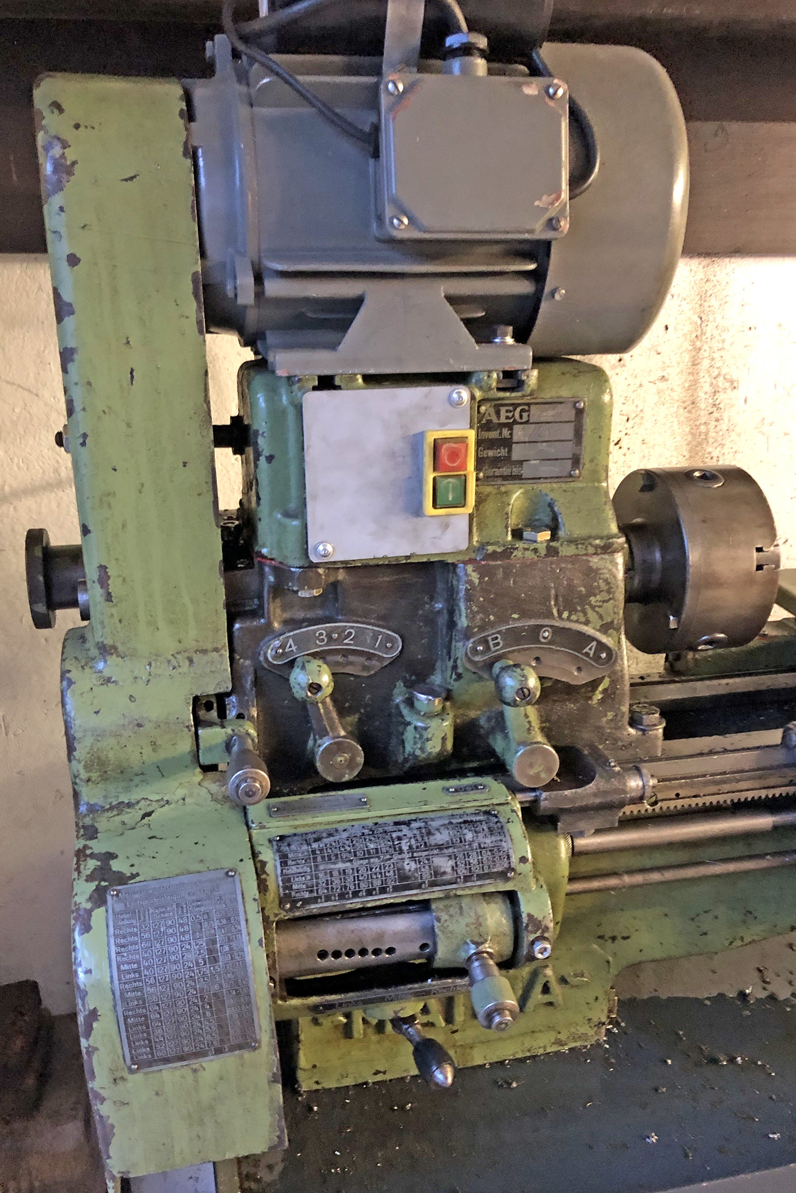

One interesting feature is the unusual location for the motor on top of the lathe, this caused by the overall width of the trucks being limited but with plenty of vertical height. Assuming that you will, in the future, also get pictures of much nicer specimens than mine, be forewarned Matra didn't provide a cabinet with the army-model lathe due to its intended use in the maintenance trucks. The civilian model is most easily identified by the fact that it has the motor on the back and, unless it has been lost over time, came with a stand.
Now the history of my example is a bit murky; it's a very late army model (1950s vintage - production stopped in the 1960s) and, judging by the inventory tag on the head, it was at one point used at the German electronics company AEG. I bought it near Frankfurt and it now lives in Austria. As a matter of fact this is the second MDR2A that I have owned, but no high(er)-resolution pictures of the first one are available.
