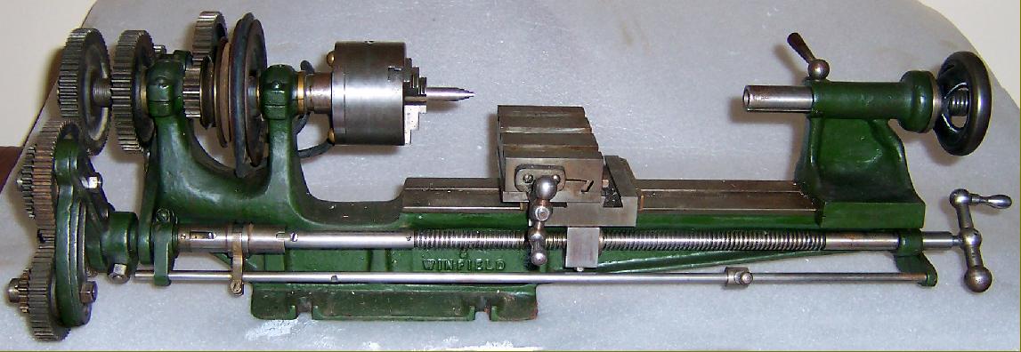

Still with the lines and detailing of the original, later models could be had with backgear and screwcutting

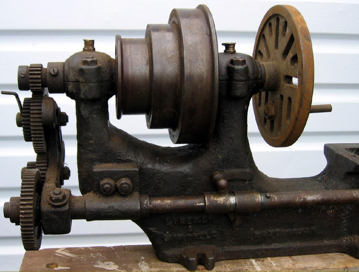

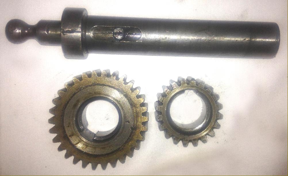

A clear view of the dog-clutch and feed auto-knock-off mechanism. The backgear assembly was clustered, like that on the better-known RANDA lathe, on the left-hand end of the headstock.

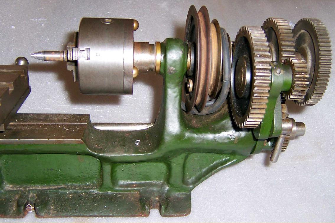

The backgear was mounted on an inner plate that pivoted on an outer plate - itself bolted to the end of the bed and providing a bearing for the leadscrew and support for the changewheel banjo.

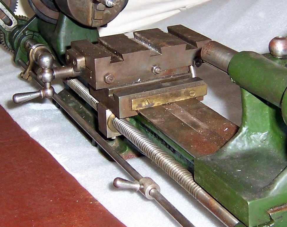

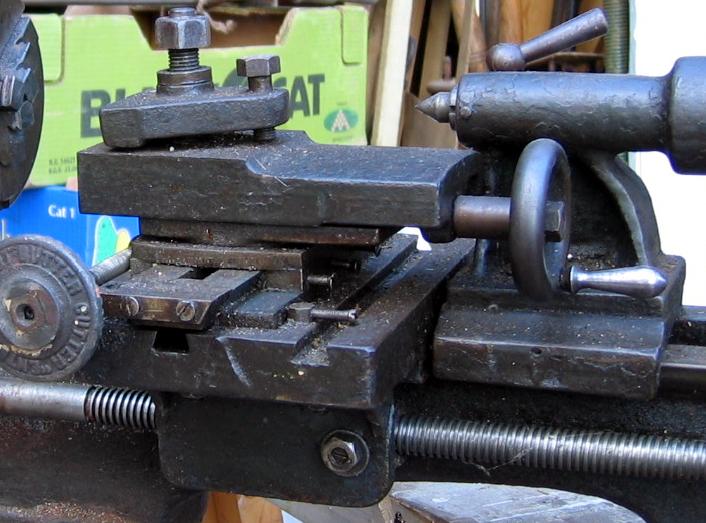

Lineker & Winfield: for its time, the use of a V-shaped slots in cross slide and saddle was distinctly old-fashioned. The cross-slide feed screw was offset to the left-hand side of the casting

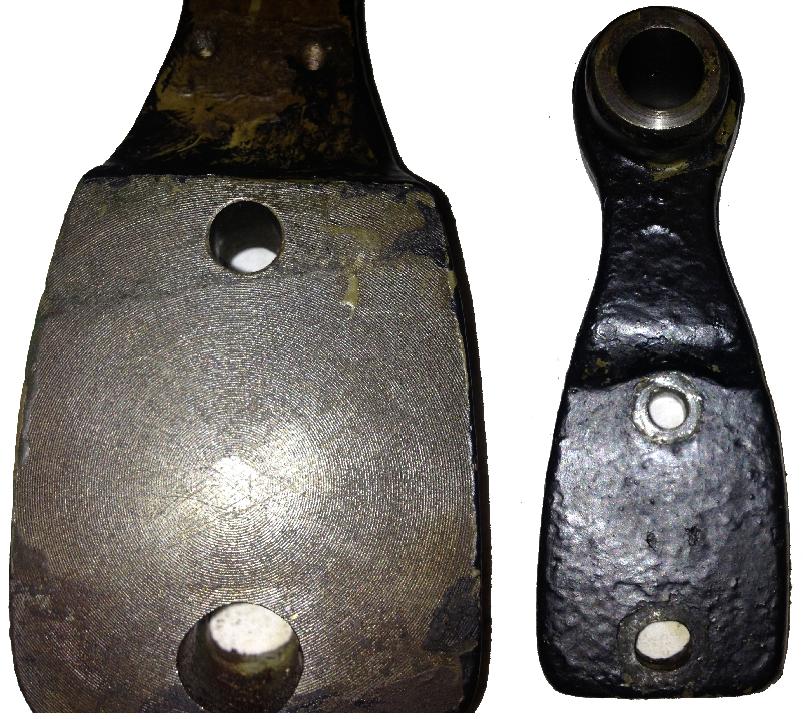

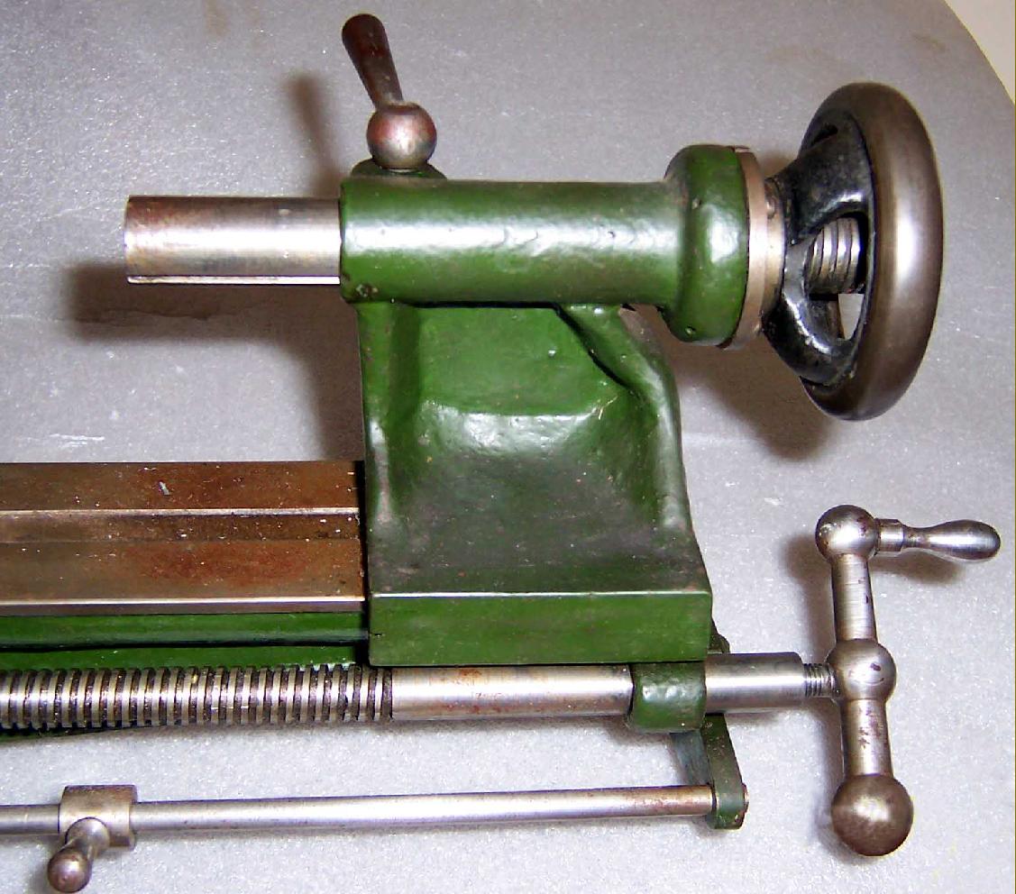

A basic tailstock with a barrel passing through the handwheel, a long split in the casting to, lock it down and a simple clap to hold the unit to the bed. The bracket bolted to the end of the bed carried both the leadscrew the carriage-drive knock-off bar.
Formed in one piece - and so unable to be set over for taper turning - the tailstock carried a No. 1 Morse taper spindle locked down by a bolt closing down on a long slot in the casting. Happily the barrel was hollow - in the manner of the Myford ML7 - and so handy for adaptation to long-hole boring in wood and simple to knock out a firmly stuck centre.

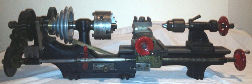

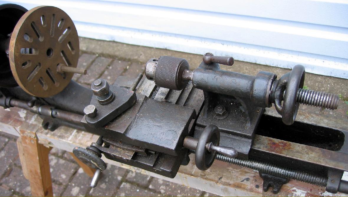

What must have been a later Lineker & Winfield with flat-belt drive and no backgear. This lathe has a number of detail design changes including a different slide-rest assembly and leadscrew carried in a bolt-on bracket at the headstock end and a cast-in bearing by the tailstock.

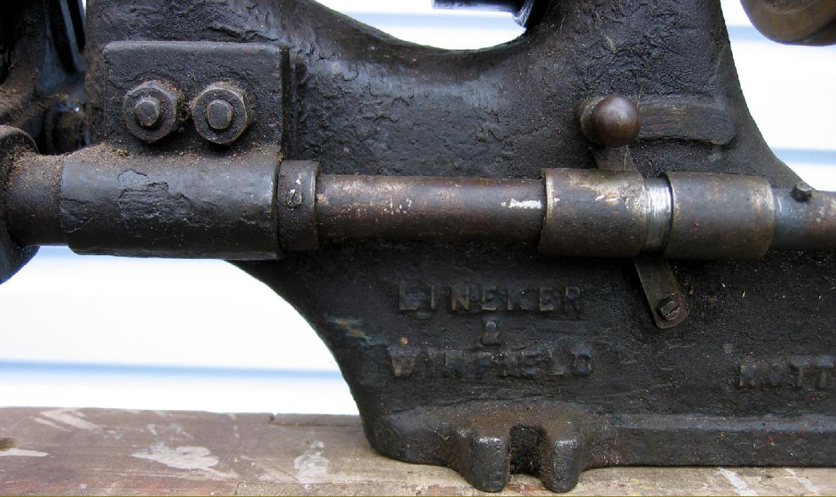

Badged as a "Sheen" with a Sydney, Australia address - but with "Made in England" left cast into the bed
