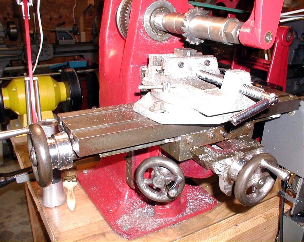

A Lewis horizontal milling machine complete with what must be the maker's countershaft unit. This example includes a bolt-on backgear (slow-speed) assembly
