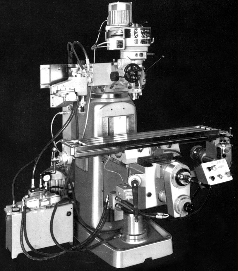

Kondia FV-1 fitted with the IMPORT-KONDIA 1-D hydraulic tracer unit (for reproduction milling) and automatic longitudinal and traverse feeds

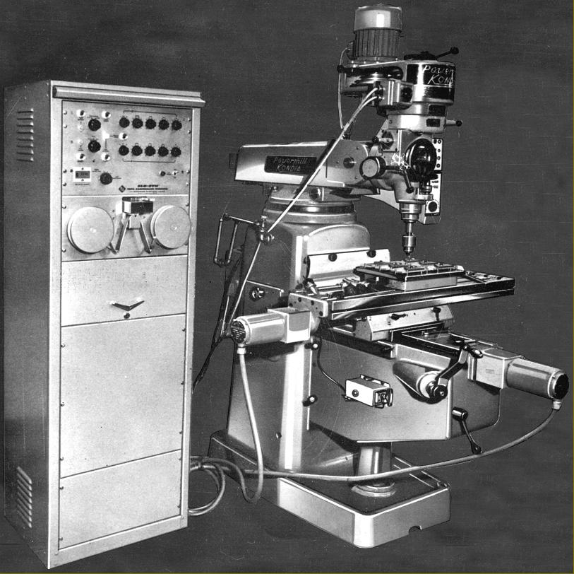

FV-1 equipped with the SLO-SYN numerical tape system
