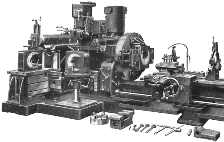

Two versions were built, a smaller type for general workshop use and a much more massive machine intended for railway workshops  - the latter bought by the London, Midland & Scottish Railway (L.M.S.) for their repair depot reorganisation that went under the title of "
The Motive Power Area Locomotive Supply, Repair, Concentration and Repair Garage Scheme". Just one example of the larger type scurvies in its original location at Carnforth and another (in active use circa 2014) at the wonderful Tyseley Locomotive Works. Although the smaller model was built as a single model, the larger, like many of its kind, was built only to order and the customer was invited to amend the specification to suit his particular purpose - for example, for use on a ship or to support a railway-repair depot in a remote region. The unit included a lathe, horizontal milling machine, shaper with hacksaw attachment and a drill. The smaller version was ingeniously designed: a Tee-slotted table at the end of the machine was used by both the miller and shaper - whilst the three-speed table-feed gearbox was also employed by the shaper to vary the stroke rate of the ram. The 7.25" x  48" gap-bed lathe was screwcutting (with changewheels) and had both power sliding and surfacing driven by a separate feed shaft. The six-speed, 3-Morse taper headstock spindle ran on ball bearings and was bored through to accept a 1.25" diameter bar; the saddle was T slotted on all four arms so that it could be employed as a simple boring table used to mount cutters for very large jobs.
Geared-head, the 3-speed drill was able to reach to the centre of a 25" diameter circle and fitted with a useful 3-Morse taper while its table, fastened to T slots on the front of the machine, could be moved sideways as well as elevated and lowered. The head was fitted with both a conventional quick-action lever as well as fine feed by worm-and-wheel gearing for boring and facing work. Later machines had their drilling table arranged somewhat differently from that illustrated below - a lower setting position was offered and a 14" by 14" Tee-slotted baseplate was fitted to hold larger work. Like most engineering companies Kitchen and Wade ran an effective apprentice training scheme, though by the 1980s, as machine-tool manufacture declined, these were beginning to dry up. One of the last decades in which training remained in full flow was the 1960s and the following account gives an interesting flavour of those times.

A view showing the shaper ram protruding from the end of the headstock. The 12" hacksaw attachment sits at the end of the machine - whilst the optional gear-driven "Circular Motion" attachment is on the ground at the back.
Although the headstock end of the machine was heavily constructed, in comparison the lathe bed was of very slender proportions.
The enormous Universal Machine Tool produced for railway repair workshops. Just one example of the larger type scurvies in its original location at Carnforth and another (in active use circa 2014) at the wonderful Tyseley Locomotive Works in Birmingham.
