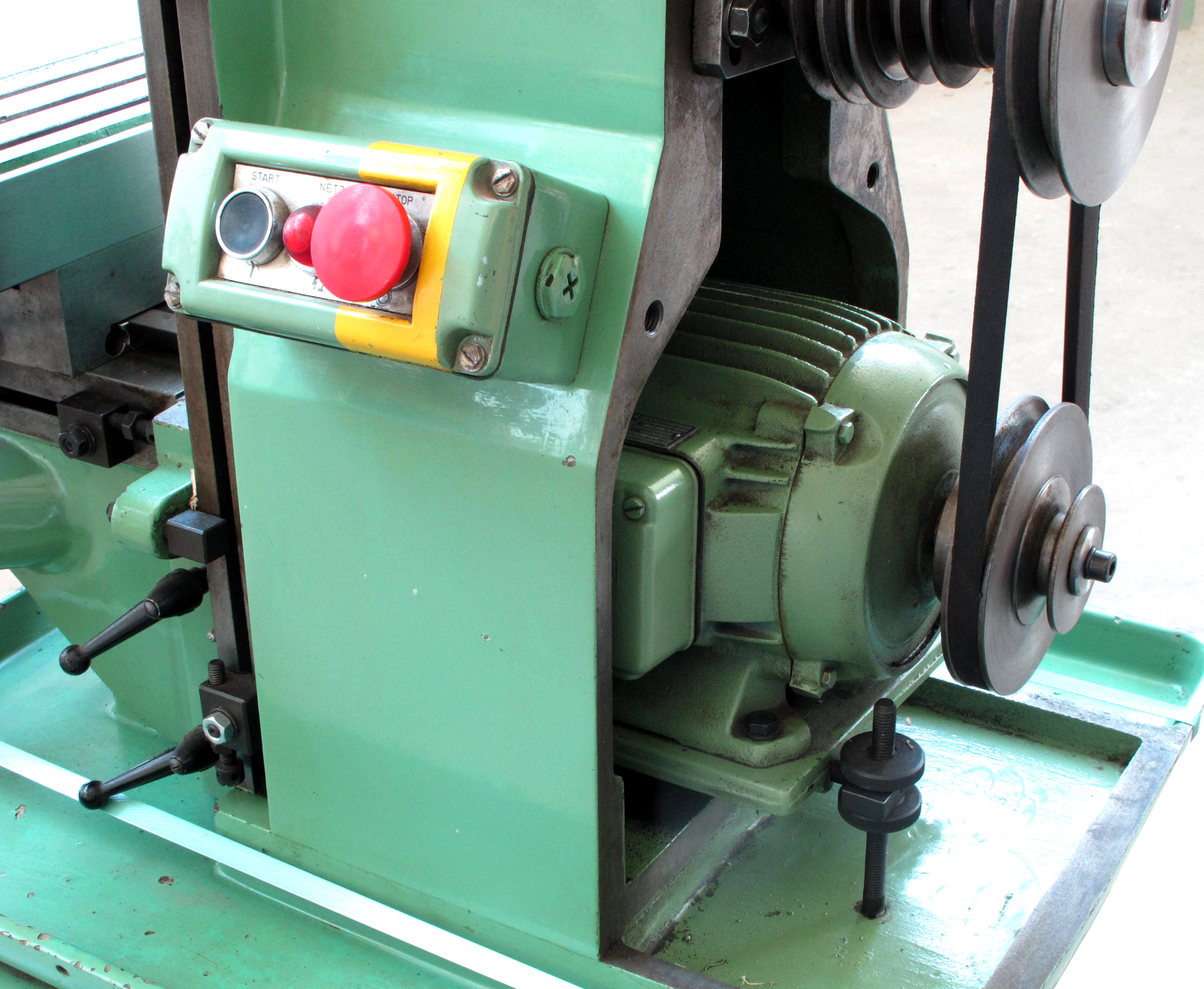

Power came from a 0.55/1 kW two-speed 750/1500 r.p.m. 3-phase motor mounted on a hinged plate at the rear of the main column. Drive was transmitted first by a two-diameter pulley on the motor that used a single V-belt to turn the input pulley of a countershaft. The latter, with twin-side-by-side V-belts for improved grip - had a three-step pulley that drove the spindle The result was a range of 12 useful speeds that spanned 112 to 2240 r.p.m.  As with many similar machines, the base was occupied by a coolant tank (in this case of generous capacity) and an electric delivery pump.
