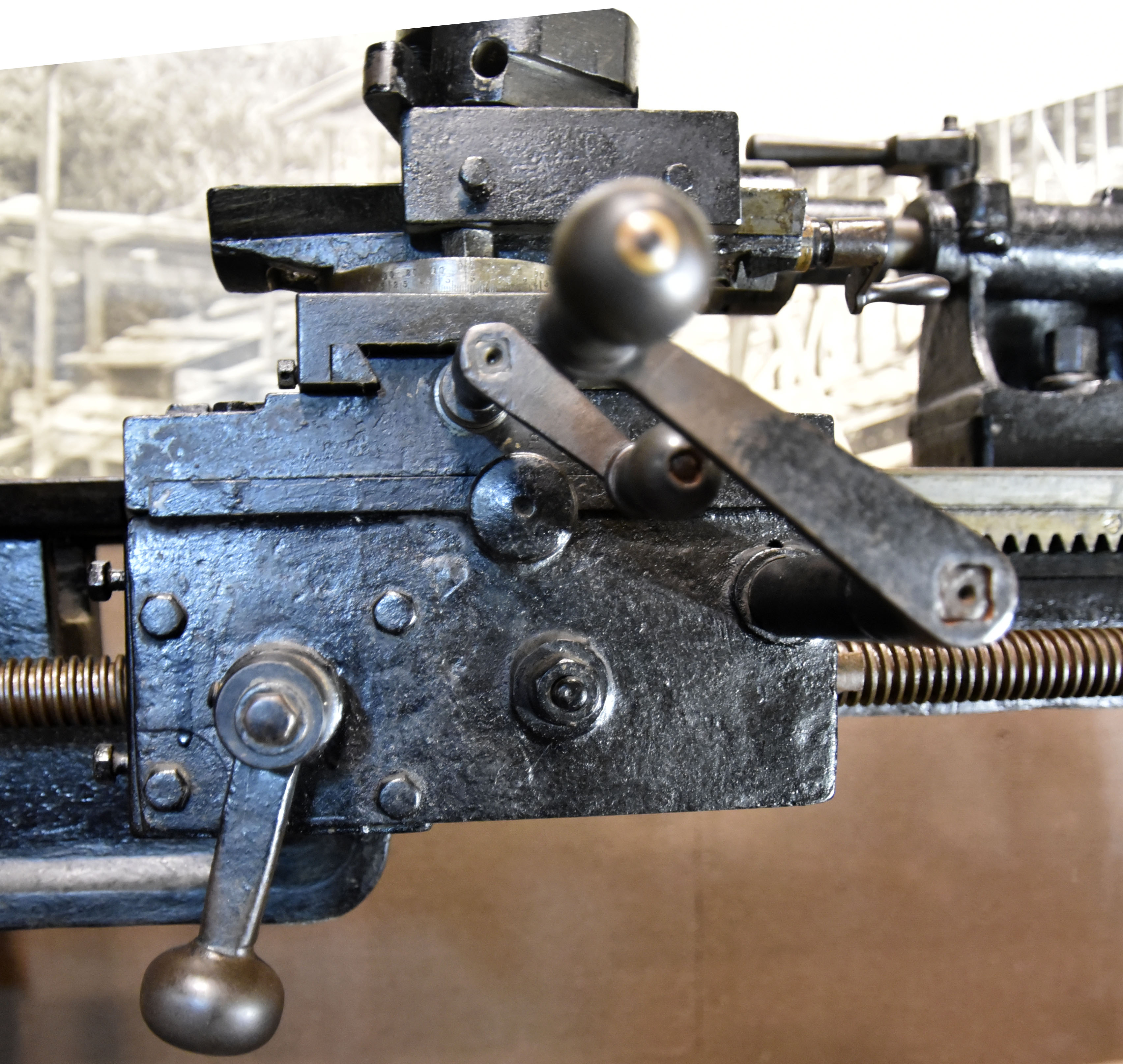

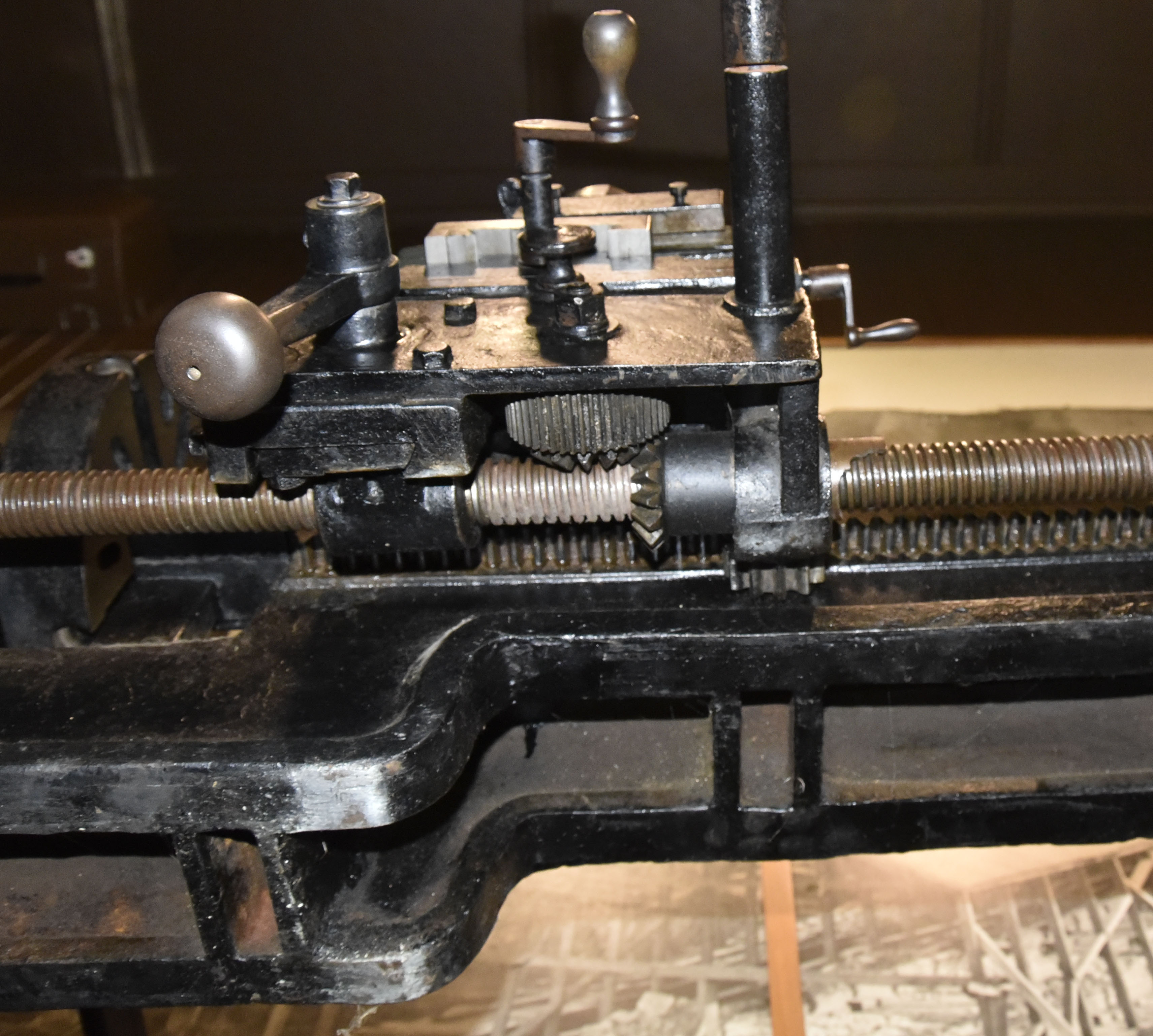

The lathe below appears to be from the Company's early years and would have been made circa 1885 to 1900.
With a centre height of perhaps 100 mm and taking 300 mm or so between centres, the lathe is of absolutely conventional arrangement for the time. Pointers to its antiquity include the outboard mounting on posts of the spindle thrust bearing, rather coarse-pitch backgears, awkward-to-use crank handles fitted to the slide-rest feed screws, a lack of micrometer dials and a pair of cast-in supports on the back of the bed to hold a wooden tool tray. Sharing one particularly awkward feature of many 19th century lathes was the crude arrangement provided for moving the saddle by hand. This consisted of a bed-mounted rack, engaged directly by a gear connected to the large crank handle - the practical effect being that a small turn of the crank moved the cutting tool a disproportionately long way. Even so, for a relatively small lathe of the time, the lathe does enjoy a spring-loaded selector for the tumble-reverse drive to the leadscrew, a gap bed, power cross feed (a button selector can be seen on the face of the apron) a proper compound slide rest assembly and a generally robust build. The faceplate fitted is of the once-popular type that doubled as a light-duty, independent 4-jaw chuck with, in this case, what would have been when new, screw-controlled sliding jaws..
