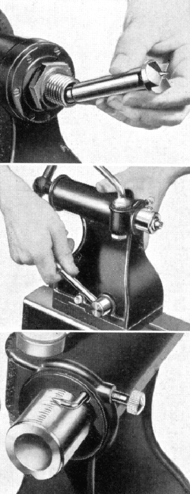

Able to be set over for taper turning when cutting metal, the tailstock had a graduated  barrel with an adjustable zero indicator and was operated by a proper, balanced, ball-ended handle. It was clamped by a proper two-part pinch bolt (not the crude split casting employed by most competitors) and sported a proper locking handle on the bed clamp. The icing on the cake was a proper No. 2 Morse taper centre - a sign that the makers regarded this machine as much more than just a plaything.

2 Morse taper centres
A proper split clamp for the tailstock barrel - and a lever operating through an eccentric for the base.
Neat adjustable zero pointer
