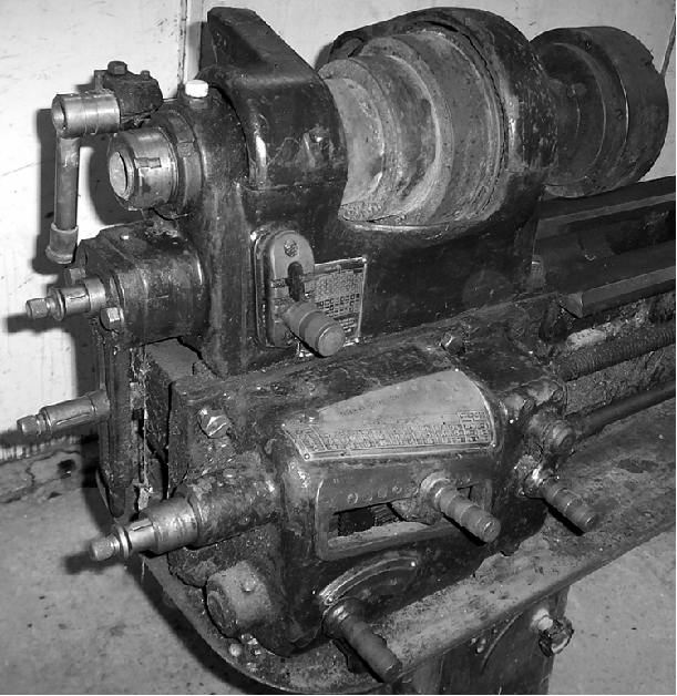

With the changewheels supplied the Norton-type quick-change screwcutting gearbox provided English pitches of 2 to 30 t.p.i and, with a change of drive gears, metric of 0.25 to 15 mm pitch. The leadscrew was used only for screwcutting with a separate shaft, driven from a lever-operated sub-gearbox on the right-hand side of the screwcutting gearbox, powering the power sliding and surfacing feeds. Unusually for a lathe of this class, the power sliding feed could be automatically released by an adjustable collar sliding on the powershaft - a useful fitment and one omitted from too many ordinary lathes of a similar size from the 1940s onwards.

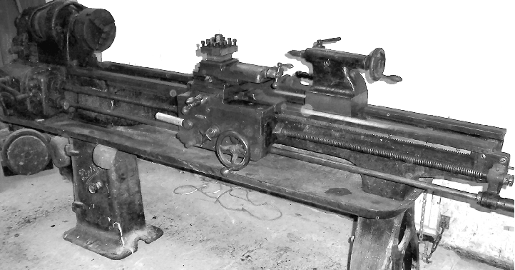

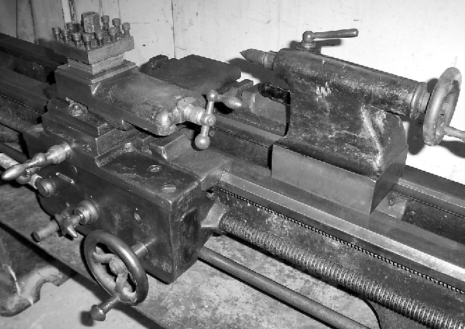

Not the lathe described above but a Chekko Lathe of the 1920s and 1930s  - a design typical of the time and one that reflected the widespread use, even in "metricated" countries, of Imperial measurements and specifications, for example: all the fastenings seem to be Whitworth, the leadscrew is 4 t.p.i. and the spindle nose 6 t.p.i. However, rather puzzlingly, whilst the cross slide and top slide screws are 6 t.p.i. tiny micrometer dials engraved with 42 graduations have been fitted a crude form of metric conversion dials.
Both larger and smaller Chekko lathes had aprons with the usual type of lever-operated double clasp nut and the power feeds selected by a 3-position quadrant lever and engaged through a clutch controlled by a star-shaped handwheel mounted concentrically with the lever's mounting shaft. The carriage drive handwheel was on the "European" (right-hand) side of the
A long-bed Chekko lathe stretched to the limit by including a considerable overhang beyond the tailstock-end
