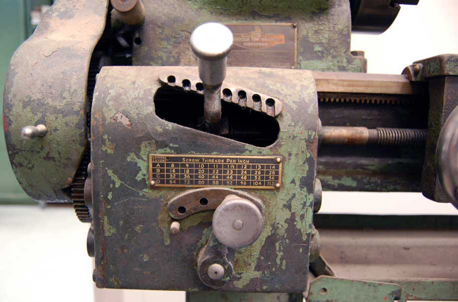

1940 Brown Model S and SF with a modified screwcutting gearbox
with a quadrant second selector and separate power-feed shaft
