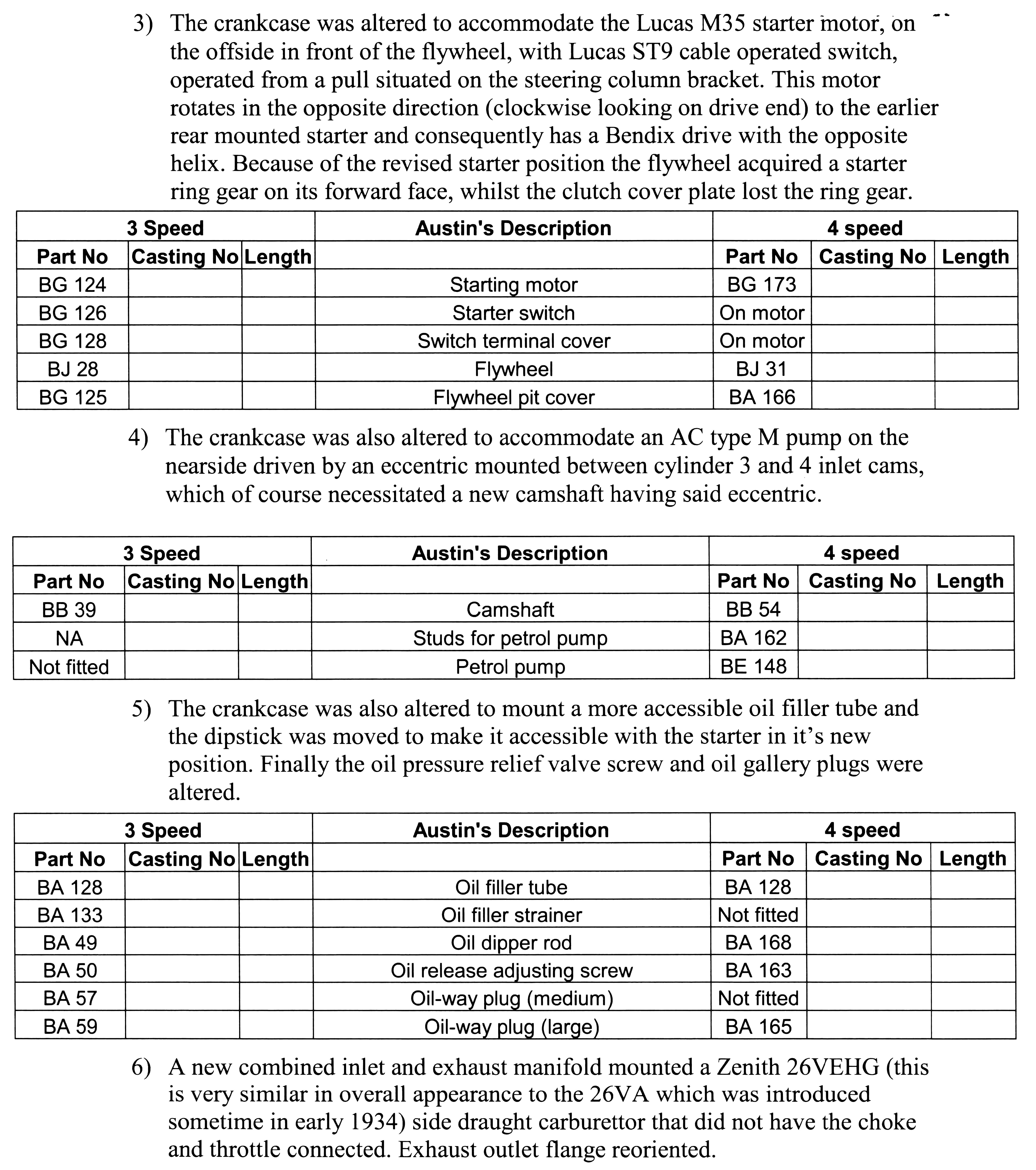

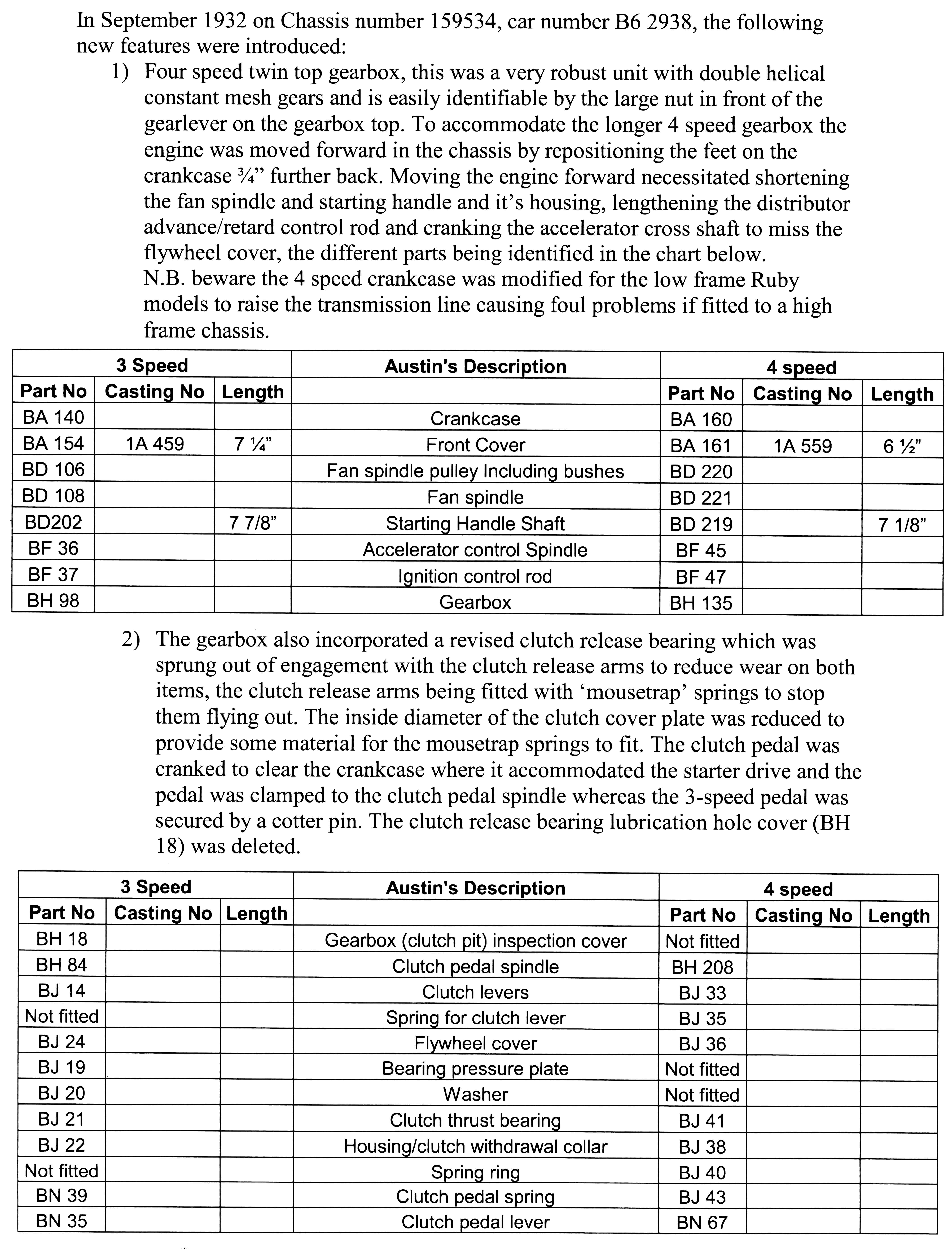

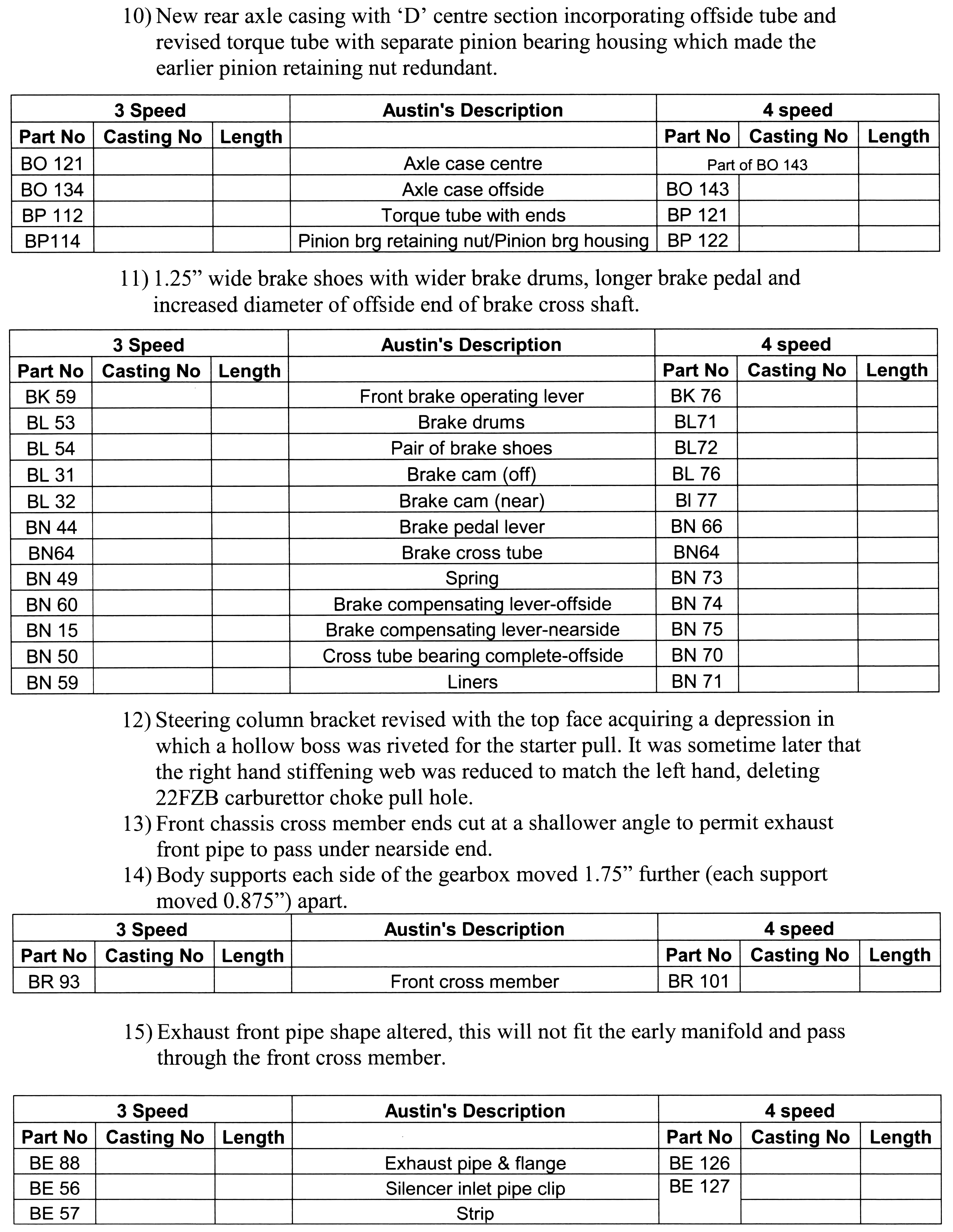

5) From chassis 159534, in September 1932, the RN was given a major change preparatory to the introduction of the narrower RP saloon in October.   This included the four-speed gearbox, a rear petrol tank, a D-type rear axle, instruments mounted in a separate panel in front of the driver, and concealed vertical rear body seams. To accommodate the longer 4-speed gearbox, the engine was moved forward approximately ¾" by repositioning the feet on the crankcase, and the starting handle housing and fan spindle were shortened by ¾".  The exhaust tailpipe was also rerouted over the rear axle to the back of the car; previously, it terminated under the rear axle.    I also suspect this is when the all-black Lucas Graves double filament double-dipping headlamps with 10 vertical flutes in the glass were replaced by the later all-chrome lamps.   In this guise, the only external clues that this model is an RN are the sunroof, the scuttle waist moulding, and the absence of trafficators.
