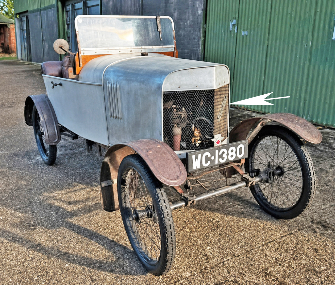

Reduced to a skeletal status, the "Wonder Car" was part car, part motorcycle, and part aircraft-inspired economy exercise. At £75 complete, it was £90 cheaper than the Seven after Austin had cut the price from £225 to £165, but this substantial saving came at a price: namely, almost everything. The "Wonder" had first been shown on Stand 25 at the 1920 Motor Show, priced at £164 : 4s : 0d  (or at £265 with a 7 h.p. flat-twin Coventry-Victor engine, so the £75 must have been a last throw of the dice to clear unsold stock.

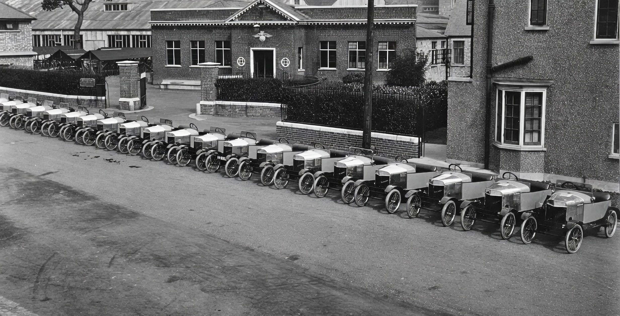

Built by the Grahame-White Company at Hendon, London, the "Wonder Car" came from a firm better known for its aviation expertise and, hence, experience in building light yet strong structures. Its immediate predecessor was the Grahame-White 'Buckboard' of around 1919. This used a rear-mounted, air-cooled, single-cylinder, two-stroke engine, bought in from Precision, with a bore and stroke of 74 mm by 91 mm and a capacity of 348 cc. It was rated at about 3 hp and drove through a two-speed transmission with ratios of around 6:1 and 10:1, then by a chain to the rear axle.
By 1920, this model had been developed into the two-seat "Wonder Car" and advertised at £75 complete. The engine had been moved to the front, and now rated at 3 to 3½ hp, or 3.3 hp in some contemporary listings. Influence from motorcycle practice was evident in the hand lever on the steering wheel for controlling the Amal carburettor and the use of a kick-starter to start the engine. Transmission was a two-speed chain-and-dog arrangement, with the same top-gear ratio of 6:1 but a lower ratio of 12:1. Final drive was by chain, with a clutch incorporated into one sprocket, though there was no differential.
As with many similar cyclecars, the chassis was constructed from an ash frame, braced in an aircraft fashion, with timber floorboards and light metal or aluminium body panels around the scuttle and the rear of the body. The wheelbase was close to that of the Seven at 6 feet 5 inches, with ride comfort depending on the flexing of the chassis; the undamped quarter-elliptic springs fitted front and rear, and with whatever flexibility could be extracted from the upholstered bench seat.
Wire-spoked wheels carried narrow 24 by 2¼-inch Palmer Cord high-pressure beaded-edge tyres. Electrical equipment was minimal: just a six-volt accumulator to run the small scuttle-mounted lamps. While a full-width windscreen was fitted, along with a perfunctory hood, there were no sidescreens.
The advertisement claimed a top speed of 30 mph and an economy of 50 mpg, the latter confirmed by contemporary tests in which, on a Surrey route (described as 'demanding' in one publication), 51 mpg was achieved.
In 1921, Grahame-White also offered a larger, short-lived 7 hp model with a longer 8-foot-1-inch wheelbase. This model used a 689 cc Coventry Victor twin-cylinder engine with a variable-speed friction drive.

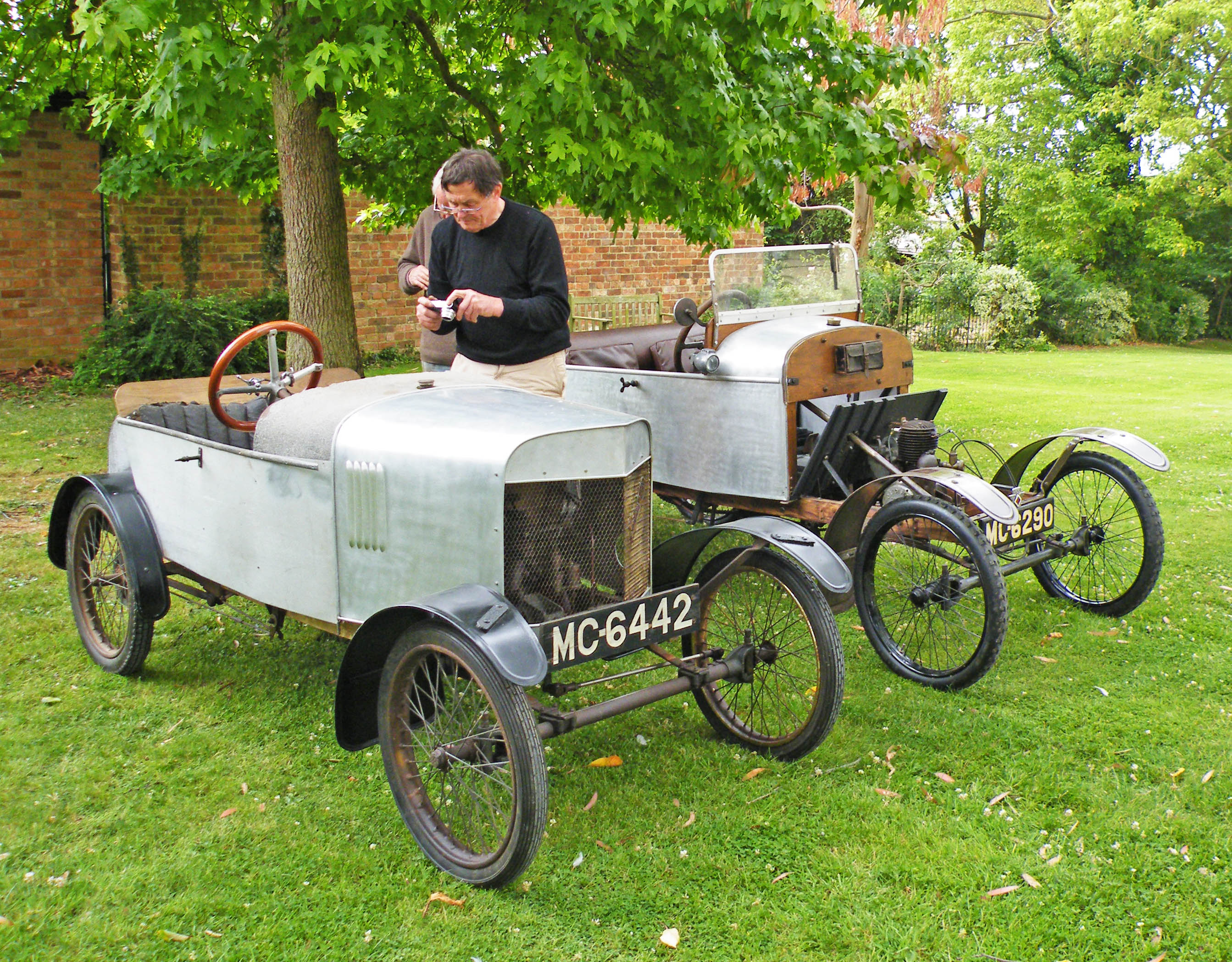

For more on the "Wonder Car", and a surviving example, see the following; be sure to watch the video - and then give thanks that Sir Herbert Austin chose to take the advice of Stanley Edge and use a 4-cylinder water-cooled engine: See the following: https://walesclassiccar.wordpress.com/.../the-worlds.../...
and the cycle car in action: https://www.prewarcar.com/proof-at-last-the-grahame-white...
