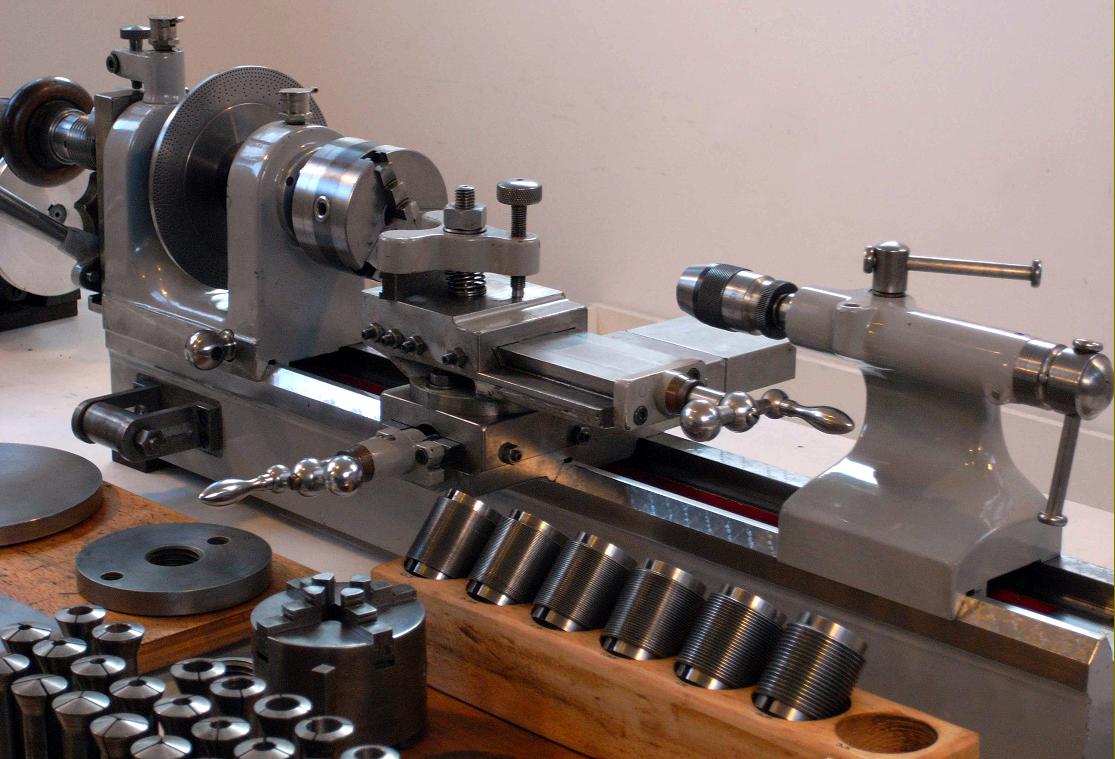

An Auerbach of unknown vintage fitted with sliding headstock spindle chase screw cutting. Judging from the compound slide rest handles and tiny micrometer dials it would have been manufactured before the 1930s
