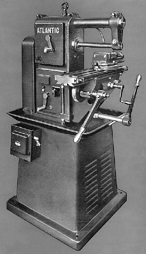

The Atlantic "geared-head" miller was manufactured by the Atlantic Machinery Corporation of 149 Broadway, New York. in, so far as can be ascertained, the 1930s and 1940s.
The 1 hp drive motor was held within the cast iron base - which also held the standard-fit coolant pump and tank - and drove up via twin V belts to a 6-speed gearbox, contained with the body of the miller, and holding gears which were all forged and hardened; whilst the standard machine was dispatched with a bottom speed of 150 rpm and a top of 675 rpm, alternative ranges were available to special order including 200 to 900 rpm and 3000 to 1350 rpm. The #9 Brown & Sharpe taper, forged-steel main spindle ran on ball bearings and was ground finished for its entire length.
The table had a working surface 6" x  24" and both "lever handle" and "crank" feeds to its longitudinal movement; when operated by the "crank" the travel was 18 inches, but under the control of the "lever handle" this was reduced to 12 inches; the table vertical moment was 8.5", and the cross feed 5.5". Although the cross-feed screw was fitted with a micrometer dial, the table's longitudinal movement had no feed indication at all whilst the vertical feed relied upon that old stand-by, a knee lifted by a lever and the micrometer collar against which it rested raised or lowered to alter the depth of cut.

Atlantic All-geared Horizontal Hand Milling Machine - Circa 1942
A closer look at the 1942 Atlantic seems to show that the machine had been left in a utilitarian "war finish".
