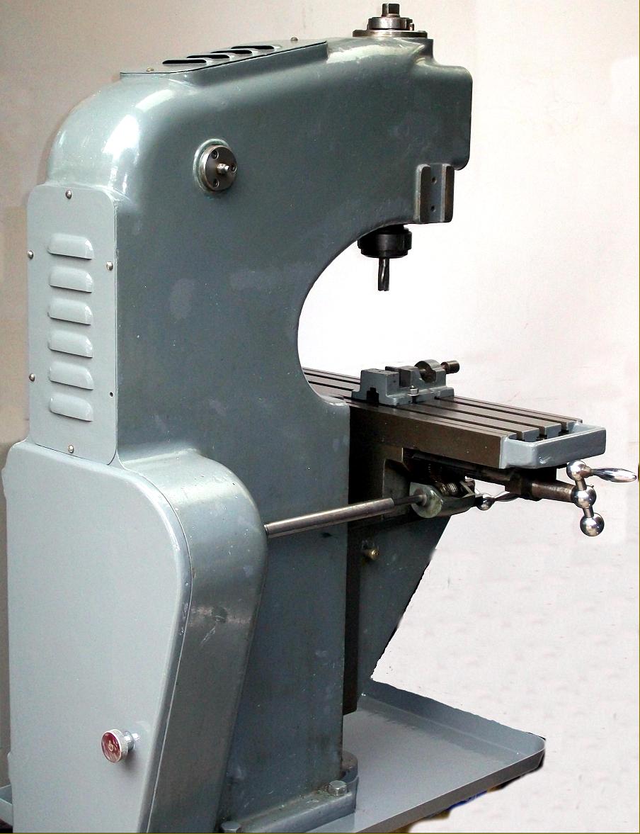

Introduced during the  late 1930s, the Mk. 2 version of the Geo. Taylor miller was a completely revised machine distinctly different to the earlier version. It was engineered with an enclosed drive system, a modified knee assembly and a much more massive head holding a precision ground and heat-treated  spindle with its lower end running in tapered phosphor bronze bearings and its upper end in a ball race - with a hardened steel split washer to take the thrust.  The old fashioned and awkward-to-operate feed handles were replaced by proper balanced types and finely engraved, satin-chromed micrometer dials fitted - that on the table's longitudinal feed screw being especially large.
Four spindle speeds were provided of 430, 740, 1220 and 2090 r.p.m. from a 945 r.p.m. 1 h.p. motor mounted in the base of the machine and driving through Brammer-type link belt. A neat solution to driving the table's power feed (longitudinal only) was to use a V-belt power take-off from the main drive pulley, the feed rates varying from a slow of 0.5" to a fast of 10" per minute. Unfortunately, as the drive for the table was taken from the driven pulley, not the motor shaft, as the spindle speed increased so did the rate of table feed. The distance from the spindle centre to the column was 8" and the maximum clearance beneath the nose 10".
Fitted with adjustable automatic stops the power-feed table had a working surface of 17.75" x 5.5"; the longitudinal travel was 8.75", the cross 3.5" and the vertical 8.25". Mk. 1, through a 3-speed gearbox powered from the main spindle - an inexpensive system to engineer but one that meant the feeds increased in speed as the spindle ran faster. The miller stood 61" high with a depth of 33" and a width of 27". Its approximate weight was 728 lbs.

The much-improved George Taylor Mk. 2 vertical milling machine
