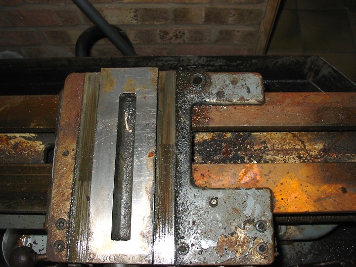

Now it was time to look at the Lathe itself as I could now get it lifted up on to the clean stand for a more thorough investigation. First impressions were not good, as witnessed by the following pictures. The top slide was practically jacked off, and initially it looked like a horror story underneath. |
| Surprisingly, it all cleaned up rather well without too may ill effects to show. Obviously there was wear (I'll cover that later in the actual rebuild), but no nasty craters or large pits from the rust, and nothing broken or seized up. | ||||
