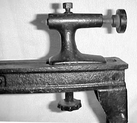

Tailstock of the No. 1 and No. 2 lathe

This was a build-it-yourself concept with the manufacturer providing the headstock, tool rest and tailstock, leaving the customer to find two length of well-seasoned 2" x 4" hard wood which were mounted to provide a 5/8" slot between them
The No. 19 lathe had a swing of 10 inches and a distance between the No. 1 Morse taper centres of 25 inches - however, the provision of Morse sockets was a $2 optional-extra, the centres were otherwise held in place by set screws.
The bed was economically constructed  from 1/4" thick steel angle which - and the makers made much of this - had been planed flat on the top; a slot, one-inch wide was milled down the centre to locate both headstock and tailstock. The headstock was bushed with brass, not an ideal material, but one which the makers pointed out could be replaced for just 25c.
