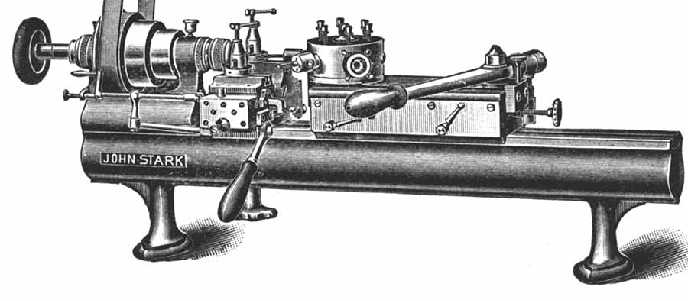

The Stark No. 3 7-inch swing Precision Bench Lathe was intended  for use by "Electricians, Machinists,  Astronomical and Surgical Instrument makers and for the manufacture of Fine Machinists' Tools and Machinery of every description". The capacity between centres on the 32-inch long bed was 18 inches and the through-collet capacity ranged from 0.020" to 0.400". On its introduction it was the only lathe of its type fitted with a spindle having the end thrust taken on a ball-bearing (anti-friction) race. More pictures here

Stark No. 3 lathe fitted with an eccentric-height adjuster boring tool mounted on a special slide to speed up repetitive boring and facing work. Whilst the cross feed used an ordinary lever-operated arrangement, the longitudinal feed was by a rack-and-pinion mechanism engaged by a large handwheel at the back of the unit.
