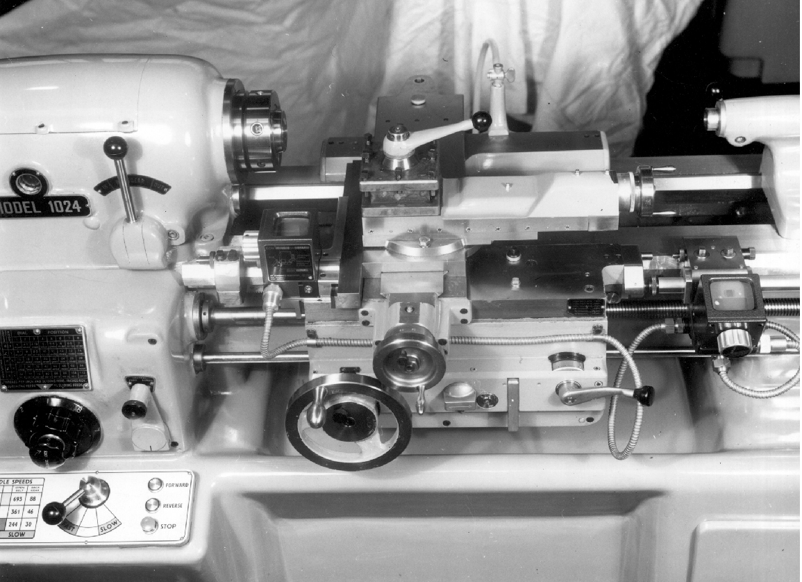

A thread-dial indicator was built in. Not the adjustable stop for the automatic carriage disengage
Boley-like apron controls - though the carriage handwheel is not original
As on the Boley original the whole of the changewheel bracket was arranged to swing in order to provide a "tumble-reverse" to the leadscrew drive
