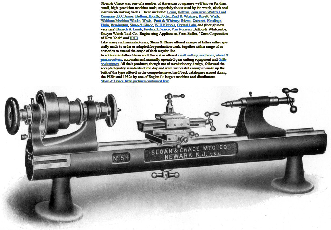

Sloan & Chace were one of a number of American companies - Levin, Bottum, American Watch Tool Company, B.C.Ames, Bottum, Hjorth, Potter, Pratt & Whitney, Rivett, Wade, Waltham Machine Works, WadePratt & Whitney, Rivett, Cataract, Hardinge, Elgin, Remington, and (though now very rare) Frederick Pearce, Ballou & Whitcombe, , Sawyer Watch Tool Co., Engineering Appliances and Fenn-Sadler the "Cosa Corporation of New York" and UND - who were all well known for their small precision machine tools, especially those used by the watch, clock and instrument-making trades. Based in Newark, New Jersey, USA, Sloan and Chace made small milling machines, wheel & pinion cutters, automatic and manually operated gear-cutting equipment, drills, tappers, specialised production machines to order and a well-known range of  precision "plain-turning" bench lathes. All their products, though not of revolutionary design,  followed the accepted quality standards of the day and were successful enough to make up the bulk of the type offered in the comprehensive hard-back catalogues issued during the 1920s and 1930s by one of England's largest machine-tool distributors.

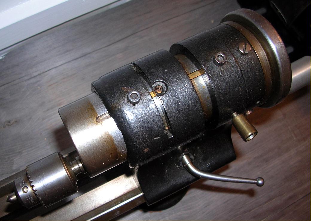

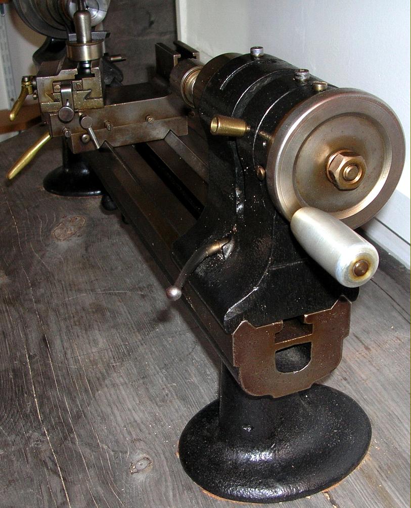

Sloan & Chace No. 51/2 precision bench lathe. Because the bed was formed with two symmetrical V ways the milling and grinding slide could be fitted on a compound slide rest that was mounted back-to-front. The slide shown is carrying a collet-holding dividing unit fitted with interchangeable "notch" plates indexed by a spring-loaded pawl. In tradition of precision bench-lathes the headstock pulley was arranged with its smallest diameter towards the spindle thread so that the all-important front bearing could be surrounded with as great a mass of metal as possible. The edge of the largest spindle pulley was drilled with a single ring of 60 division holes (competitor machines had up to three rings) and the front of the bed immediately below the headstock had a short T slot machined into the first few inches of its front face so that a screwcutting attachment could be bolted in place.

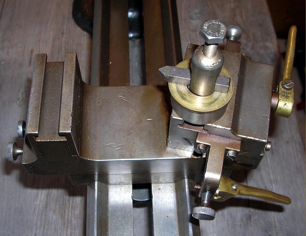

Lever-action cut-off (sometimes called a  forming slide) topped with a short-travel lever-action tool slide.

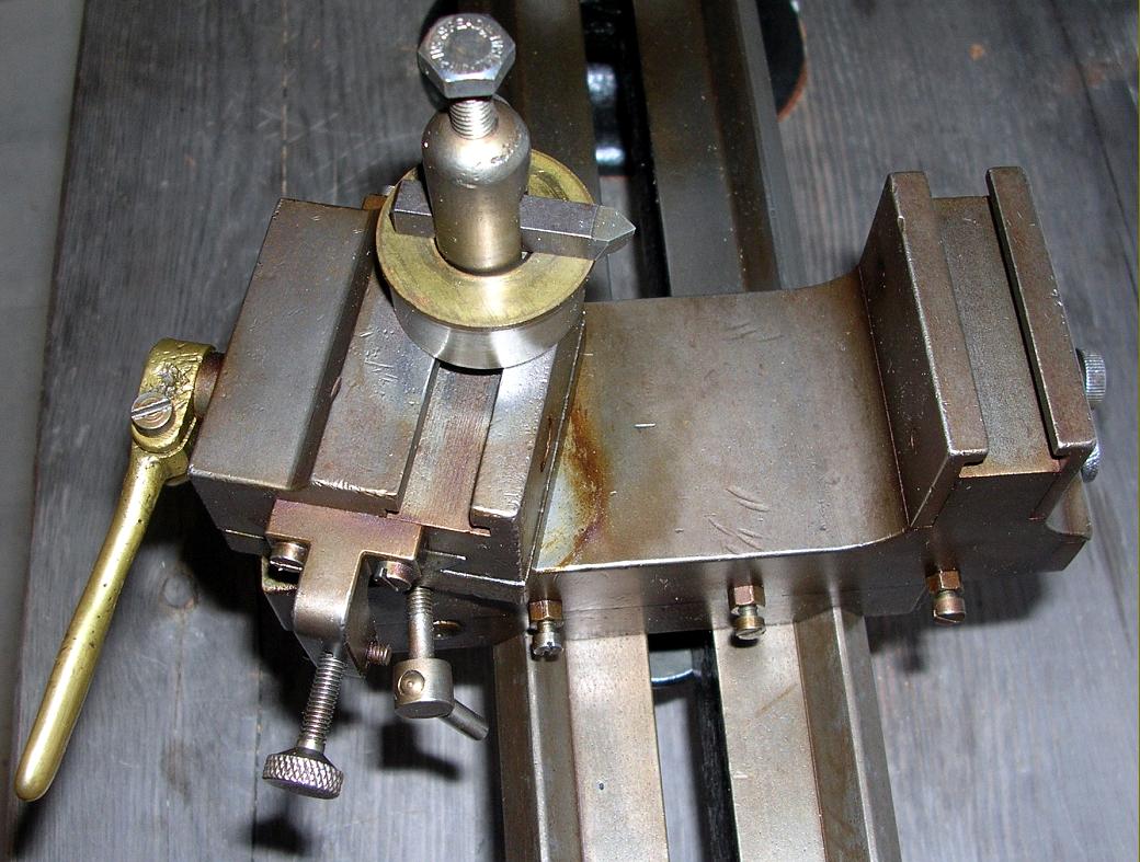

Each toolpost could be adjusted precisely for height by turning a knurled-edge ring
