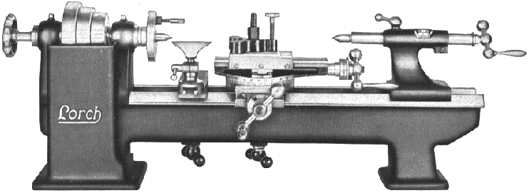

Master-thread controlled headstock with sliding spindle Type AIIP

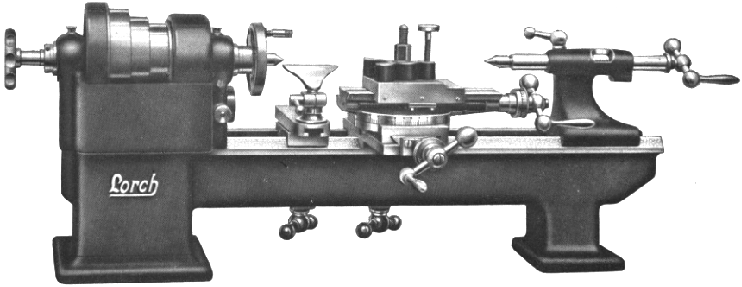

Smallest model in the dedicated thread-chasing range was the Type LLPV

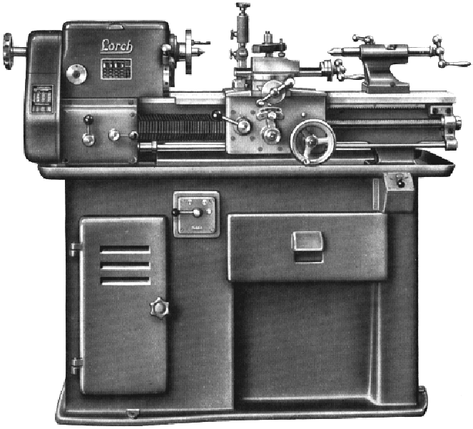

Apart from Swiss Autos, this early 1950s Lorch B VI PO-K was almost certainly the last lathe to be constructed with sliding headstock thread cutting.
