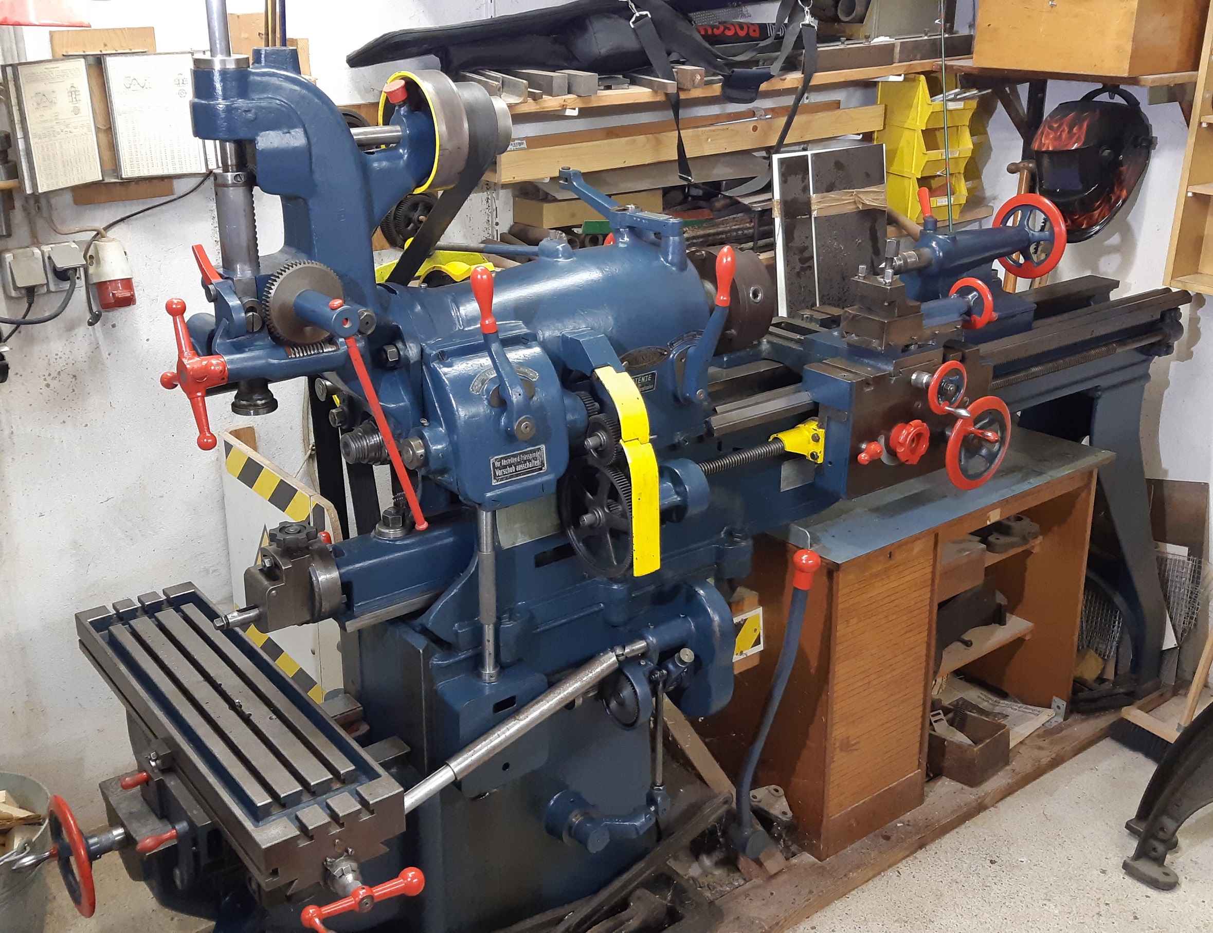

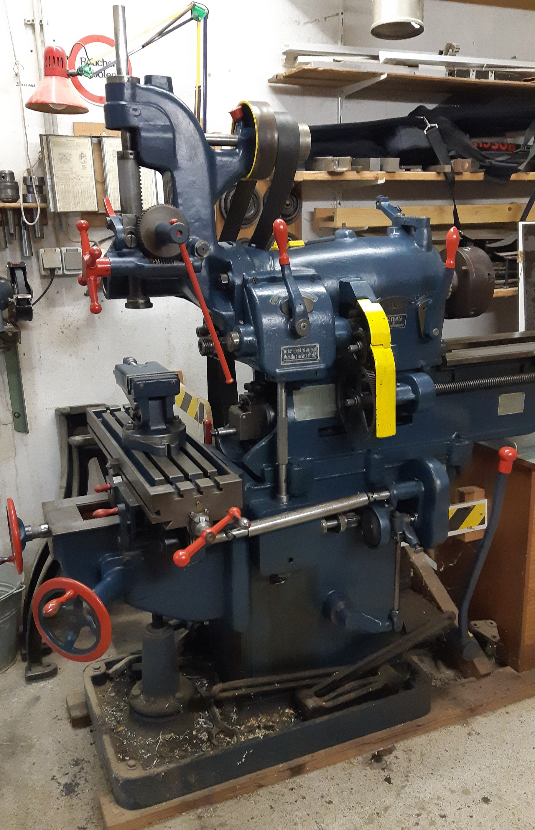

A later and more heavily-built Krause UM2 with a heavy-duty, power-down-feed drill
and lots of capacity between centres. Note the "Krauseco" badge on the tailstock-end leg

Krause UM2 combining a screwcutting centre lathe with a horizontal milling machine and drill press

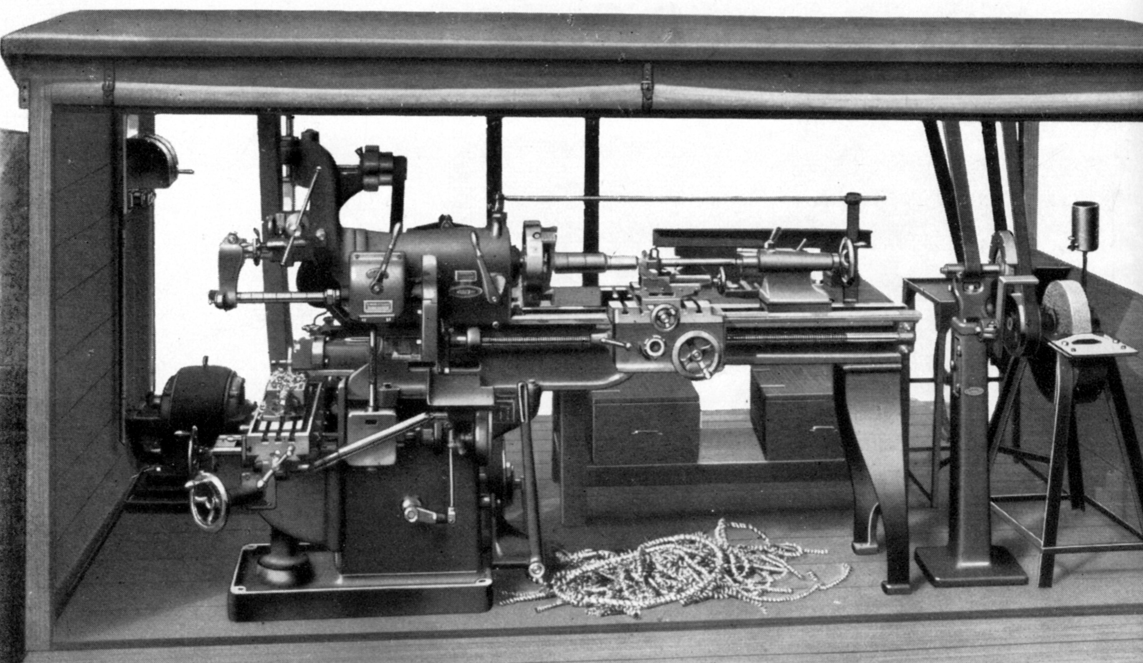

An early Krause installed as a mobile workshop in a railway truck. Interestingly, a system of line shafting was built into the roof of the truck (powered from an electric motor that can be seen in the rear left-hand corner) that drove both the universal machine and the pair of grinding wheels on the right. This particular (early) Krause has power feed to the milling machine table and 2 T-slots in each of the lathe's saddle wings so that they could act as a simple boring table.

On this early Krause Universal the bevel drive to the drilling head can just be made out.
