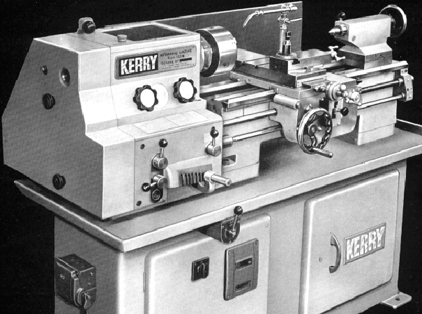

Although the built-on countershaft allowed the lathe to be offered for bench mounting the makers offered a modern, cleanly-designed sheet-metal stand with a deep drawer in the middle, a generously proportioned storage cabinet on the right and a (rather shallow) welded-on chip tray. The electrical controls were housed in the left-hand cabinet and accessible by just swinging open the door..

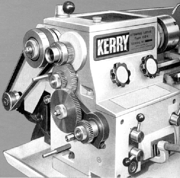

Simple headstock controls on the face of the headstock: on the right for backgear and on the left to select the 3 rates of sliding and surfacing feed.
A clear view of the two-part countershaft/motor mount and the "tumble-reverse" positioned, unusually, on the bracket through which the leadscrew passed and operated by a rod topped with a black plastic knob.
The Kerry DB could be supplied on a neat, sheet steel stand with plenty of storage space and a welded-on chip tray.
