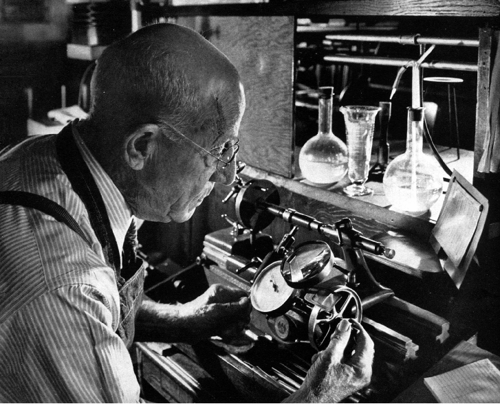

Selective assembly: in the foreground the bore of bearings to be used on the main headstock spindle are checked: in the mid-ground the diameter of a spindle's trunnion surface is measured and in the background a row of spindles, complete with their bearings.
A 0.0001" reading dial gage is used to check the bearing bore
