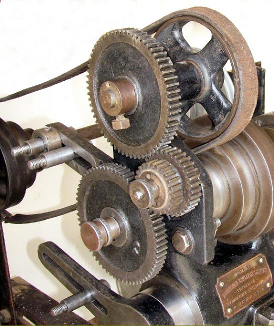

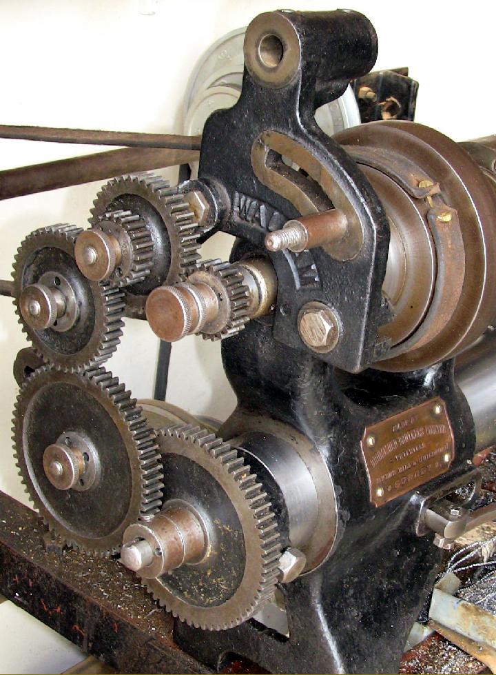

The Mk. 1 "B.S. Type" was introduced for Admiralty use in 1916 and included a range of modifications to improve its ease of use on board ships as they corkscrewed around in heavy seas. It was closely based on the standard "B-Type" machine but fitted with a power-feed apron with both longitudinal and cross feeds driven from a shaft fitted below the leadscrew  and geared to its left-hand end.
In order to make the assembly work correctly the simple full nut that connected leadscrew to apron  was replaced by a proper double clasp nut. A saddle traverse by hand-operated rack and pinion was also fitted to the B.S. and a tumble reverse for the leadscrew drive attached to the slotted bracket on the headstock front - a bracket that normally carried a stud to mount the extra changewheel required for left-hand screwcutting. When the tumble-reverse unit became available on the B.S. it also entered the accessory lists for the standard machine - however, the full B.S. specification was only available for Drummond B and M Types, and Myford M Type, destined for naval use; it was never offered on the civilian market nor, so as far as is known, never featured in any publicity literature. On the very rare Mk. 1 BS the power-feed selector arm worked across the front of the apron whilst on much more common Mk. 2 it was positioned to hang downwards and indent into slots machined into the underside face.

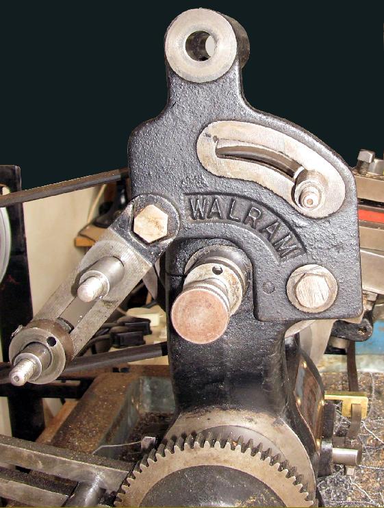

A very rare Mk. 1 BS Type with the power-feed quadrant selector arm working across the face of the Apron. The headstock of this lathe was the type with the strengthening loop over the top.

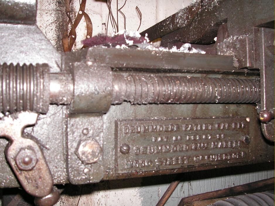

The bottom edge of the distinctly different apron of the B.S. Type carried a  spring-loaded quadrant selector with indent positions for hand or power cross feed. The ordinary B had a solid nut on the leadscrew but the fitting of power sliding and surfacing meant that a split nut, that could be disengaged, was required; this was operated by a tapered lever positioned at the top right of the apron. The spring-loaded operating knob that engaged the cross feed was of an identical design (and something of a Drummond trademark) to that used for the engagement and disengagement of  the leadscrew clasp nuts on later versions of the lathe.
Power was supplied to the apron by a separate shaft, gear-driven from the left-hand end of the leadscrew.
