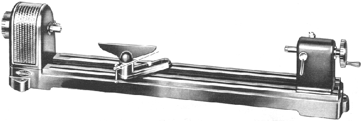

1947 Craftsman Model "80"  9-inch swing by 30 inches between centres.
When production of Craftsman wood lathes started again after World War Two the better of the two machines introduced in 1947 (1948 catalog year) was the Model "80". Despite its No. 1 Morse taper, 3/4" diameter headstock spindle running on plain, "Oilite" self-lubricating bronze bearings (and one ball-bearing race for thrust) this was a respectably heavy (78 lb) machine with all its main components in cast iron.

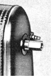

Unusually, the headstock spindle carried no thread, instead a square section was formed on its end - with faceplates and other fittings held on by grub screws - a horribly crude system that only lasted for one year - the 1948 models being fitted with not only a proper thread, but a ball bearing spindle as well, of a type first used in 1933 ....
Four spindle speeds were provided of  875, 1350, 2250 and 3450 rpm - although the motor and 4-step V pulley required to produce them were only available at extra cost and,  at $18.50, increased the price of the basic lathe by a massive 39%. If you could find your own motor it was recommended that a 1/3 hp, running at 1760 rpm, be considered the minimum that would provide a satisfactory performance. The lathe could be driven from either behind or, with suitable slots cut in the bench, from below. No speed- reducing countershaft (Sears called them 'jack shafts') was used, the motor, as on most wood lathes, drove the spindle directly.
A cover could be removed from the left-hand end of the headstock spindle to reveal a left-hand thread on which a faceplate could be mounted for large-diameter "outboard" bowl turning. Strangely, Sears missed the opportunity to offer a proper bench-mounted tool rest for this activity for non was ever listed in the accessory pages.
The lathe was finished in grey enamel with chrome plated fittings and decorated with what was to become a trademark of Craftsman products, an imitation "engine-turned" decorative cover over the headstock. The machine was 10
1/4" high, 85/8" wide and 101/8" long - and when introduced cost $47.50. Production of the lathe in an identical form continued until around 1959, when it was replaced by a new round-bed 12-inch swing model (shown at the bottom of the page).
A square section was formed on the end of the spindle - with faceplates and other fittings held on by grub screws - a horribly crude system that lasted for just one year on the Model 80 but for over thirteen on the Model "40" (later "Dunlap").

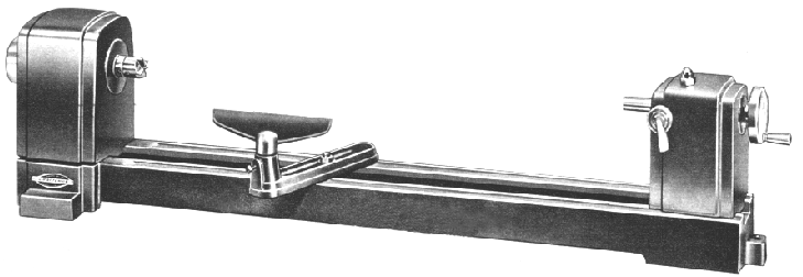

1947 Craftsman Model "40" 8-inch swing by 24 inches between centres.
Introduced alongside the Model "80" this lathe cost just $30.50, some 36% less. The same cast-iron construction was used for the major components - the weight of the basic machine was 54 lbs - and the motor could be made to drive the spindle from either behind or below. The electric motor and its 3-step pulley were, of course, extras - not surprisingly for, when supplied with the lathe, they raised the price to  $49, an increase of over 61%.
A cover could be removed from the left-hand end of the headstock and a large faceplate fitted for bowl-turning - although, as for the Model 80, no tool rest for this kind of work was to be found in the accessory lists.
The "Craftsman" name was used until 1951 when it was changed to one last used on a wood lathe in the early 1940s - Dunlap. The machine continued in production until the early 1960s - outlasting, by a few years, the original Model "80"
