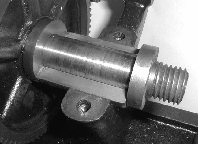

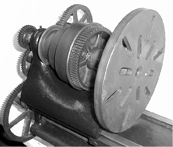

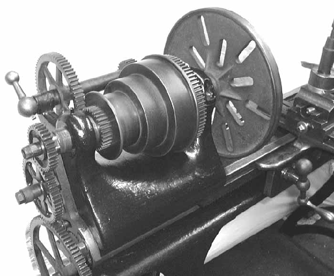

Although the base of the headstock was heavily built, the amount of material surrounding the all-important spindle bearings was inadequate.
The small-diameter spindle, long, bronze bearing (and a lack of supporting metal surrounding them) were typical of Victorian thinking - later designs would take another direction with more massive and rigid headstocks, large-diameter spindles and much shorter bearings.
