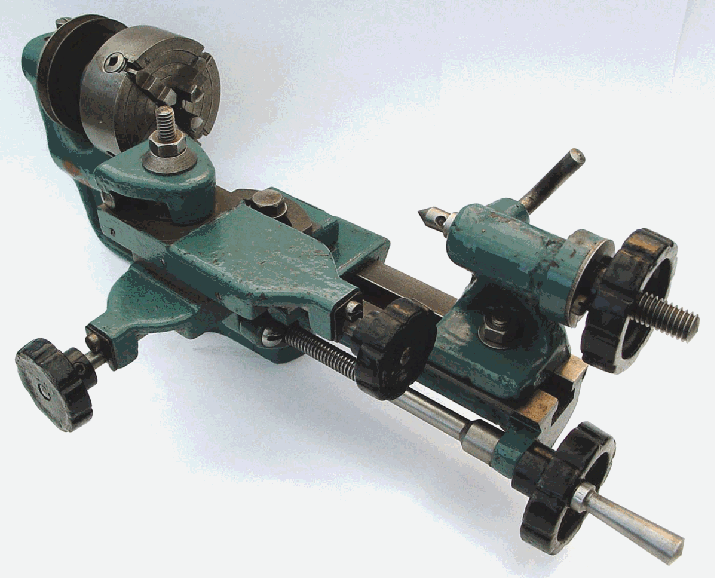

Although the background to the T.N.C. Company is not known the lathe was either imported from the United Kingdon or built under licence as a replica of the Super Adept. Only the most minor differences between the machines can be found: a straight instead of waisted carriage-feed handle; a top slide whose base casting was modified at the rear with a curved slot - the purpose of which was to improve the ease of setting over. It is just possible that the lathe was an early product of Hercus, with the name acting as a suitable disguise. Certainly, as yet, no advertising literature has been discovered for the machine and it may well have been distributed around local tool dealers "by hand" - as a convenient way of starting off what was to become a very successful machine-tool manufacturing business. Fred Portass produced a modified Adept for the department store Gamages. This was identical save for cosmetic changes to the bed casting. Other pseudo-Adepts seem to have been produced.

In comparison with the rest of the lathe the compound slide rest was relatively large - a fact emphasised in this overhead view.
The headstock was fitted with simple, bronze bushes in split housings that were adjustable over a small range; the spindle carried a 3/8" British Standard Fine (BSF) thread and a tiny taper, much smaller than a No. 0 Morse. The lathes could be driven by either a two-speed human-powered "foot-motor" and flywheel assembly, or from a small electric motor though a simple bench-mounted 3-speed countershaft. More TNC here.
